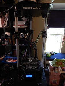

Introduction: How to Add LED's to Your 3D Printer!
So you just either bought or built your own 3d printer, and have spent hours printing little key chains and robots. Or maybe you have had yours for a long time, and are printing an InMoov robot or some cool mechanisms. Having owned mine for a solid 6 months, I felt something was lacking. Then it hit me, lights! Some 3D printers already have these, like the Ultimaker 2, and I think the Makerbot now lights up the print bed. But I have yet to see one with remote-controlled color-changing mood lights! In this Instructable, I will show you a quick and easy way to add flair to your 3D printer. This whole process took me about 15 minutes, and is incredibly simple!

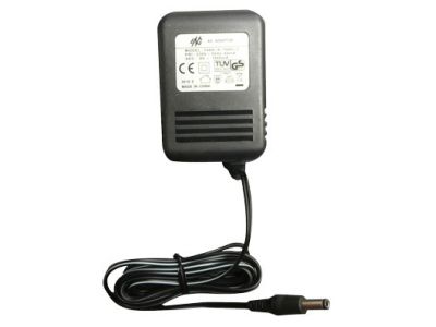

- A small wall wart power adapter (see the picture if unclear).

Now is a good chance to test everything outside the case. connect up the white box that came with your LED's to your wall wart connection. I went ahead and mounted the sensor to the side of my case as well. Plug in your LED's and cycle through the colors with the included remote. If this doesn't work, check your wiring, and ensure the polarity of your wires is correct.

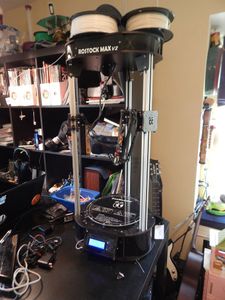

Bind the LED's together and find a place for them inside the printer. Here are some good tips:
- Look for a place where they will be visible
- Translucent panels work best for diffusing of the light
- Make sure the wiring doesn't obstruct any fans or rattle around too much
The acrylic panels on the Rostock Max v2 work great because they appear black when the LED's are off, but show off the innards of my printer when they are on. Test it once more, then put on the side panels (or whatever part of the printer you removed)!
Step 6: Your Done!
Admire your lights! Mine can be left on for 10,000 hours before they start to dim, so I'm not worried about that. Have fun modding your printer! Happy hacking!
