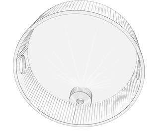

Step 1: 3D Print the STL Files Attached
Download the 3D printing software that your printer supports, in my case I am using the Printrbot Simple Metal which use Repetier-Host as a software to
- Slice the STL files attached,which basically means cutting the part into various layers
- And send commands to the 3D printer while printing
In my case I am using the following filaments HATCHBOX 1.75mm Transparent PLA and Makerbot True Red PLA.
Download the STL files attached
For the FlyingDiscLid.stl
- slicing should take about a 5-7 seconds
- and printing should take about 15- 20 mins base on your printer settings.
and FlyingDisc_Gemma_Base.stl
- slicing should take about a 45-50 seconds
- and printing should take about 40- 50 mins.

Step 6: Glue the Parts Together
Use E6000 or super glue to attach the NeoPixels to the semi transparent base 3D printed part as show in the picture above.
In addition glue the red 3D printed to the frisbee. Press and hold for a couple of mins till the super glue drys off..

Step 8: Screw the Lid to the Base
Now connect the Lipo battery to the JST female end of the Gemma and tap the fast vibration sensor to validate that the NeoPixels glow.
Using a 32x1/2 in screw and a screw driver secure the base to the lid of the frisbee as shown in the picture above.
