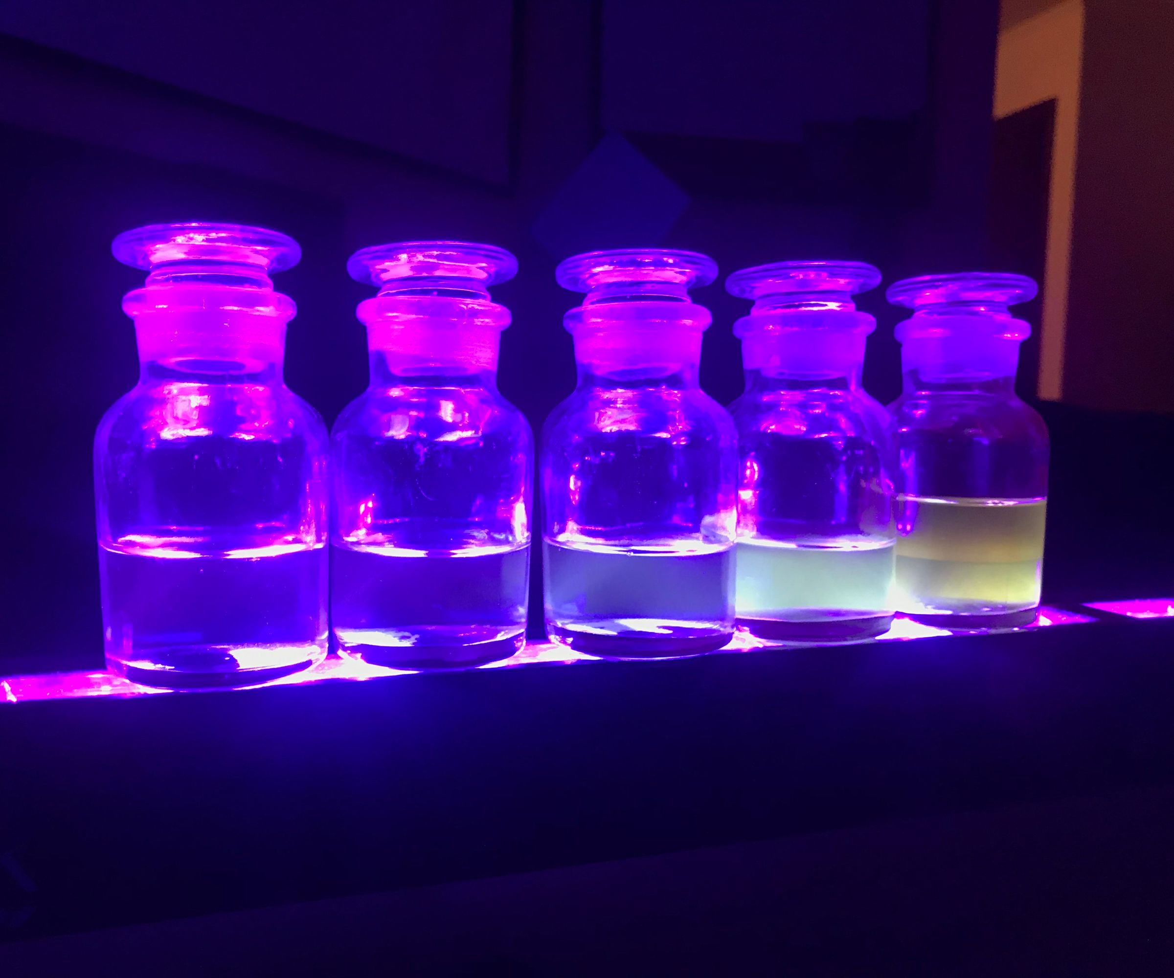

Introduction: Lightboard Coffee Table and Art Display
This project had a lot of "Winging It" involved. I am immensely happy with how it turned out but several things went sideways, which you will see. I'll tell you how I did it and then tell you how to make it better and easier than I did.
This project does use UV LEDs so it's best not to stare directly into them. Have the same caution when using this that you would using a blacklight. I don't plan on sitting directly over it or even leaving it on for significant periods of time.
