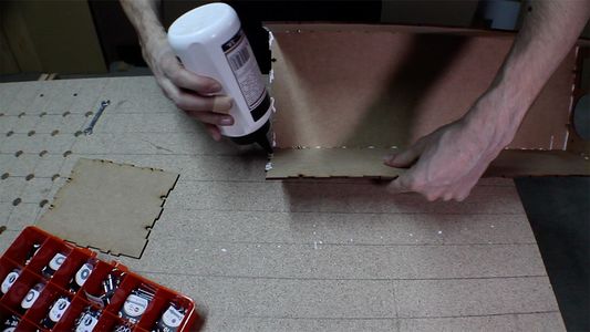

The controller structure was cut in a laser cutter and then mounted using wood glue and 4mm screws.

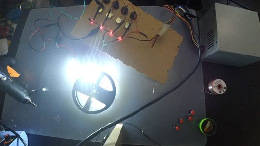

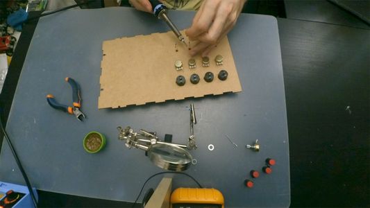

Then the various electrical components (buttons, potentiometers and leds) were assembled according to the diagram below. In order not to burn the LEDs it was necessary to add to each a 470 ohm resistor. There are four red LEDs that indicate which panels are connected and a fifth green indicating whether the controller is on.
In order to change the light intensity, was used a 1 kohm potentiometers.
The system is connected to the power supply via a molex plug.
After assembly of the components, it has been tested to ensure operation.

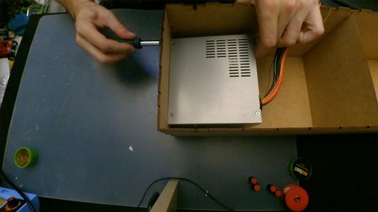

Then the power supply was installed and the assembly finished.

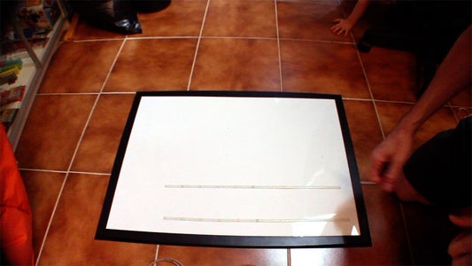

The lighting consists of an Ikea frame where the LED strips are glued.
Since the frame is larger than Lightbox, I have only installed LED tapes in the space of this one. The tape was divided into five sections.
These were installed in the frame and connected to each other in series, and later connected to the controller through a connector.

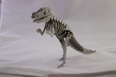

Step 5: Final Test
In the end I tested the various types of lighting to compare the final results.
