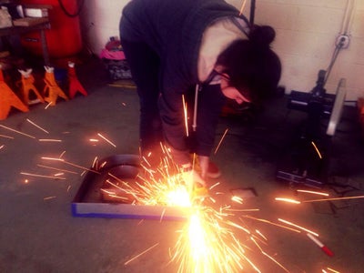

Posting this one on behalf of my amazingly talented sister Anna. I helped out with the programming but I was out of state she did all the welding and hard work.

The whole project is cut out of light gauge metal, I also ordered a bunch of 3" flat bar that we just cut to length as we needed it and then tack welded the sides onto the letter. No need to weld all the way around the whole thing, multiple tacks will suffice.
