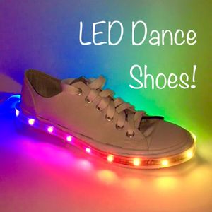

Introduction: Lighten Your Step: LED Dance Shoes!
So you've seen shoes with LED lights. But have you seen ones that change color? Maybe. How about ones that are fully programmable, packed with a micro sized Arduino Gemma, a rechargeable lithium battery, and on top of that, they have pressure sensors in the soles of the shoes. This instructable will show you how I turned a pair of canvas sneakers into dancing shoes!

Before you begin, it's a good idea to understand what you'll be wiring on the shoe. To connect the sensors, I connected one side of the sensor to ground, and the other to the analog pin A1. The pins of the led strip: DIN GND +5V, connect to the Gemma pins: D0 GND Vout. The Vout pin directly powers the strip from the battery.

Now that the shoes are finished, it's time to program them. I wrote this code using the neopixel library provided by Adafruit. The program I made simply sends a pulse of light running up both sides of the shoe as you activate the heel pressure sensor, changing hue every step taken. You can program these shoes to your liking. Here is the code I made:
