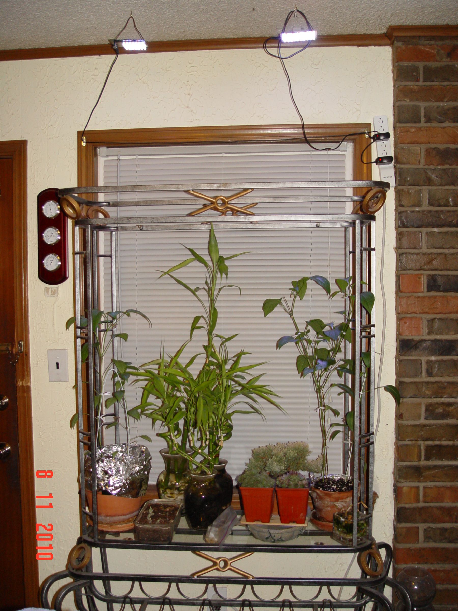

I've had a hardcore affinity for LEDs of all sorts. It began with a journey to make my own grow lights and evolved into so much more than I expected. Since than, I have experimented with many of the usual LED wearable forms such as a sound reactive tie, an LED Belt, and several iterations of LED goggles; All to run around and confuse the living daylights out of people. But now my neurons have decided to create a crazy mashup. I think of it as a light theremin, thus the name of Lighthemin.
