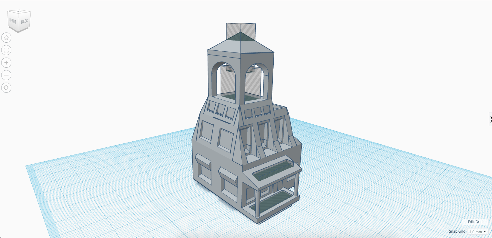

Step 3: Design: Lighthouse
This model is fairly complicated; it took me around 3 hours to design in TinkerCAD even after brainstorming the initial design. In this step I will run through the main sequence of designing this lighthouse planter.
The first thing we need to do is create a window template. We will copy-paste this throughout the design to quickly get an indented window shape.
Next, place a rectangular prism and create the entrance using a rectangular prism hole.
We can now add some basic furnishings. I put two doors in the entrance, some window overhangs on either side, and a nice patio in the back.
I finished up the first floor by copy-pasting the window shape and cutting away an overhang over the entrance.
The second floor's design is trickier. I used roofs, wedges, and quarters of pyramids to construct an interesting exterior. I also added a balcony using a rectangular prism and cylinders.
The back wall of the second floor was looking boring, so I used rectangular prism holes to create columns.
I then used the window template again to add windows to the second floor.
The third floor was relatively simple. I used wedges, pyramids, and a rectangular prism to slope inwards towards the lighthouse portion of the building.
I then used smaller windows to decorate the third floor.
I also added window overhangs to two of the windows in the front.
I added doors and windows to the wall facing the balcony and added a railing to the balcony. This railing also allows you to add soil and grow micro greens in the balcony itself.
For the beacon, I added a rectangular prism topped by a roof.
I then cut away the inside of the beacon to create the four distinctive pillars on the four corners.
Most importantly of all, I cut away holes in the patio and beacon for plants and holes in the roofs of both for sunlight to enter through. This step is crucial if you plan on using this design as a planter.

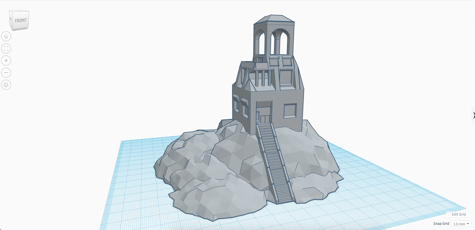

Step 4: Design: Terrain + Gazebo
We need to extend the lighthouse downwards so that when we add the terrain, none of the doors, windows, etc end up embedded in the landscape. To do this, I simply added rectangles below the lighthouse.
To create the rough terrain, I used the asteroid shape generator. I simply grouped many of them together and changed their sizes and locations to create a mountainous landscape.
I cut away the bottom of the asteroids to create hills and cut away the areas where the staircases will go using holes.
The staircases were trickier to design. I rotated rectangles for the railings and used smaller rectangles for the steps. I ended up creating a simple staircase template and copy-pasting it over and over to create the longer staircases seen below.
Once I finished the terrain, I moved the lighthouse on top of the landscape and fitted the staircases so that they were in the right positions.
To create the gazebo, I cut away a portion of the terrain to the left of the lighthouse.
I then copied the beacon from the lighthouse and used it to create the gazebo. Finally, I cut away a hole in the gazebo for plants and a hole in the roof for sunlight to enter through.

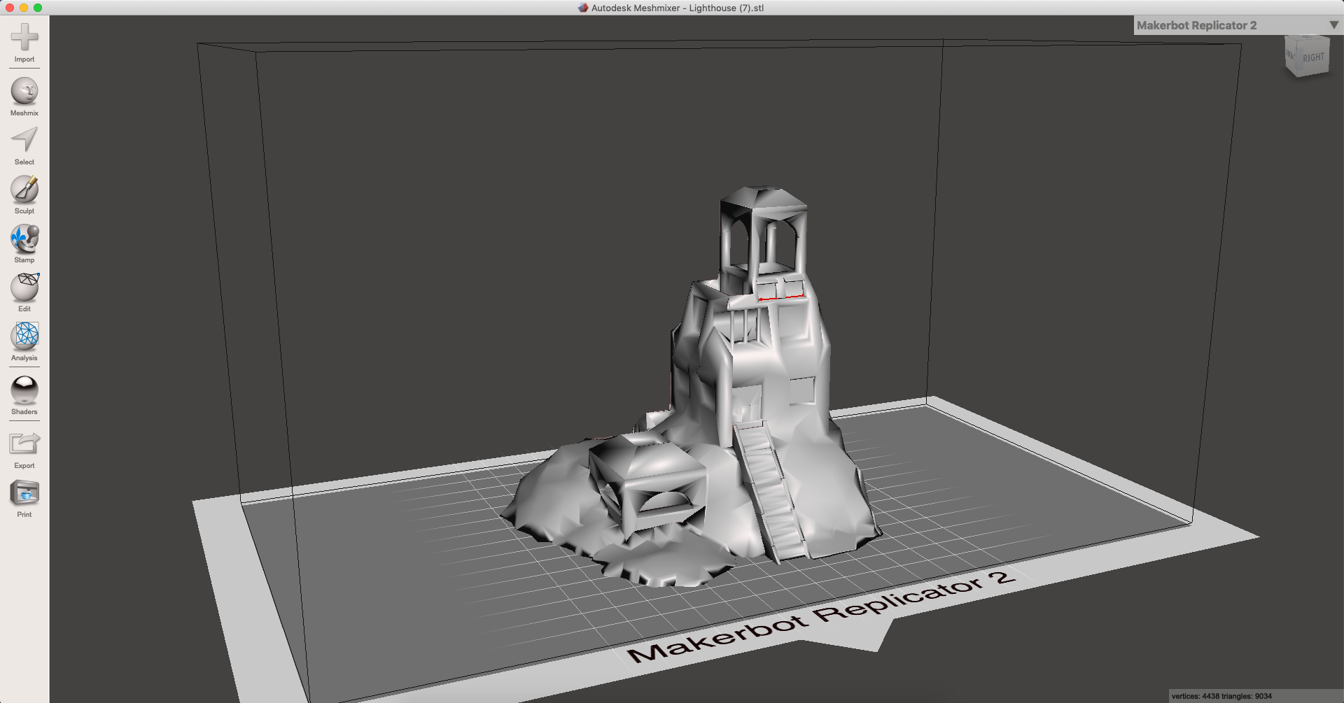

Step 6: Hollow Your Model
If you want to hollow your model (not recommended for 3D printers that use filaments), load your file into Autodesk Meshmixer.
Autodesk Meshmixer will try to smooth the surfaces of your model, which we don't want. To fix this, go to Edit -> Generate Face Groups and adjust the settings until your model is back to normal.
To hollow out your model, go to Edit -> Hollow and Increase the Offset (AKA wall thickness) to max. Then click "Update Hollow" and click "Generate Holes." These holes will allow the resin to drain out of your model instead of getting stuck inside.
To export, click File -> Export, change the file type to a .obj, and click "Export."
The purpose of hollowing out your model is to reduce material costs when using an SLA printer and printing using resin. If you are printing on a filament - based printer, do not hollow out your model and instead just decrease the infill density. Since FDM printers place filament layers on top of each other, your model won't be able to print if it is hollow since filament can't be placed on top of air.
