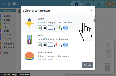

Step 3: Add Devices
  1. On the first smartphone, add the Lamp component.
  2. On the second smartphone, add the Switch component.
