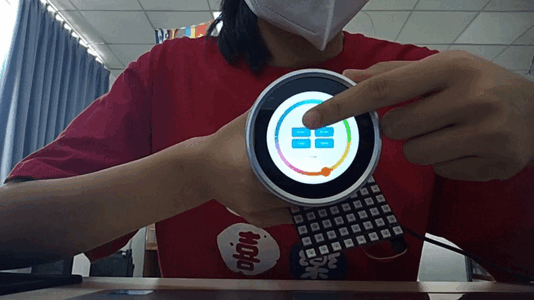

Step 4: Result
When I open the switch, the WS2812 lights up, and the LED's color changes with the color of the colorwheel knob. I can change the colorwheel knob position by touching the screen or rotating the encoder. And when I click the button,the light will be turn off at the setting time .
