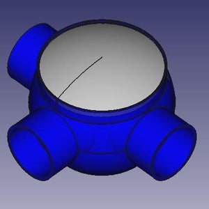

For this structure we need to print 8 nodes:
- 1x Main Node
- 2x Nodes type L
- 2x Nodes type T
- 3x Nodes type I
- 2x Top Nodes type L
- 2x Top Nodes type T
- 3x Top Nodes top type I
- 7x Front Top
- 1x Top Main Node
Repository where you can find all the 3D desings.
Thing to take into account when printing.

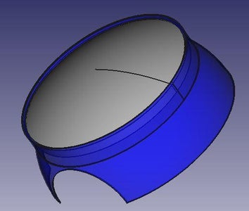

The idea behind the Nodes is that they need to be robust enough to be able to hold the impacts and at the same time the front part of the nodes let the light go through. For these is recommendable to print the nodes body in a colour that can absorb the light as a black or navy colour. While the front tops will have to be in a clear or translucent material, in our case we use white, it is not 100% translucent but it let the brightness goes through really well.
As soon as we have all the nodes with their tops printed, the assembly of them it is really easy. The first thing to do is place the translucent front top inside the clamping cylinder (See Image 1)
After this we will place all the electronic components inside to check that it is enough room for all the electronic components and then we will proceed to place the top node on their respective node. This design has not mechanical lock so we will need to ensure that all the connections and welds are correctly done and secure before we seal the nodes together because after this point it will be really difficult to correct any mistake inside the nodes. (See Image 2)

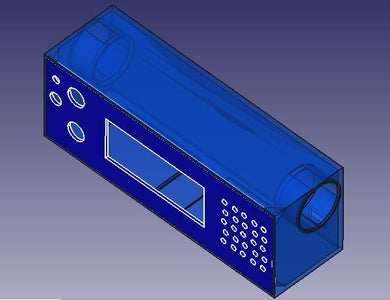

For the Main Node we will check that the top fit in to the base an all the electric components can fit inside in their respective positions. (See Image 3)

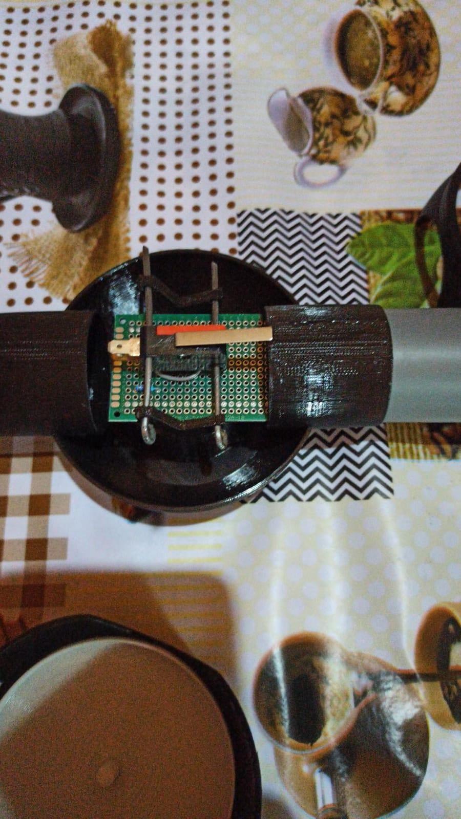

On the first stage we need to ensure that the board and the microinterruptor are place in his site. They can be a little loose, but the important thing is that they are embedded in the area designated for them
Then as soon as we see that the sizes are the right one, we can start to plan how we are going to do the welds of the components on the board. Starting by placing 2 outside lines cables to do the GND and VCC lines, these will make thing easy later on.
After this we will weld the resistances as close as possible to one of the corners of the actual board to avoid these interfering with the microinterruptor when we will have to fit it later on. And make it easy for us to connect the data cable for the LED strip.
As soon as we have them ready, we will need to weld the bottom line to the GND leg and the main one leave for the time when we have to do the interconnections. To continue we just need to weld the Neopixel strip, for this, one of the cables will go to the GND, the other one to the VCC and the last one to one of the resistance leg, in the second leg of the resistance we will connect the cable which will come from Arduino.
