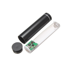

2>5 v LED strip(RGB or White) ,Single cell power bank, Small Switch for Option-1

Option 1. Make a sword with inbuilt LED & battery.
Option 2 > make Sword for Showcase and use external 12 v LED strip and adapter.
I consider both in design.
If You want to change the option after making the first option, you can change.
Just you need to add an internal Li-ion battery power bank,5V LED strip and switch, which is enclosed inside the Grip part. you need to take measurement of each part and fit inside enclosure grip.

For option 1>
 If you choose an internal battery, use a 5v LED strip and switch.
It's easy to fit the battery and switch hhh inside.
Solder some wire for connect the switch battery and LED strip.
