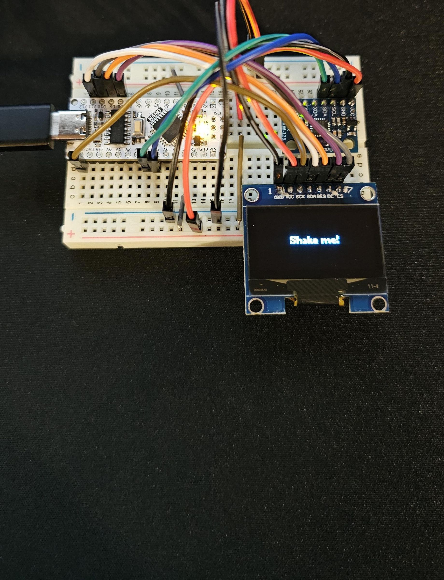

I'm thrilled to introduce my latest project: a real-time Lightning Tracker for North America! By leveraging Blitzortung’s powerful WebSocket API, I've developed a system that continuously monitors lightning activity across the continent. Here's an overview of how it works:
  1. Data Acquisition: A script runs smoothly on an Amazon EC2 instance, connecting to Blitzortung’s WebSocket to receive live data on lightning strikes.
  2. Intelligent Processing: The system decodes the incoming information and filters it to focus exclusively on events occurring within North America.
  3. Instant Notifications: When a lightning strike is detected in the specified region, the script sends the keyword “lightning” via WebSocket to my ESP device, enabling real-time alerts.
  1. ESP32-WROOM
  2. LEDs
  3. Resistors
  4. Jumper Cables
Step 1: WiFi Status LED
  1. Pin Connection: Connect the WiFi status LED to Pin 14 on the ESP device.
  2. Resistor: Use a resistor in series to limit the current and protect the LED.
Step 2: WebSocket Status LED:
  1. Pin Connection: Connect the WebSocket status LED to Pin 16 on the ESP device.
Step 3: Flexible LED Filaments:
  1. Pin Connections: Connect each of the three flexible LED filaments to Pins 18, 19, and 22 respectively.
  2. Resistors: Each filament should have its own resistor to ensure proper current flow.
  3. Functionality: These LEDs will flash simultaneously whenever a lightning strike is detected, providing a visual representation of storm activity.
Step 4: Upload Code to ESP32
Upload the code to the ESP32. Changing Wi-Fi information and server information for your usage.
