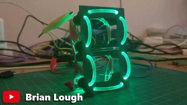

What if I told you that you could build a display out of shoe laces!? Well that is exactly what I've done!
Building your own seven segment display is nothing new, it's a very common Arduino project, but I had an idea for this one so I said I'd give it a go, and I am absolutely delighted with how it came out!
It's made from Light up shoe laces (light pipe), some addressable RGB LEDs (Neopixels) and a 3D print.
The idea behind this design was inspired by the Cob LED projects that Unexpected Maker and David Watts are working on.
In this Instructable I'm going to show you how I made it and some thoughts and suggestions I have for a second version!

Step 3: The 3D Print
What an age we live in that we can create physical objects in a matter of minutes! This display would be so much harder to make without a 3D printer!
I designed the part up in Thinkercad. I started with making single pieces so I was happy that the concept was working before I wasted a lot of time and plastic making useless 7 segment displays! You can see my iterations in the Thinkercad link, I was having some troubles printing the thinner ones, and also some light was bleeding through.
Find this part on Tinkercad and also on Thingiverse
One thing to note is that the lightpipe didn't fit into the holes I had drilled for it, I needed to drill out the hole with a 3mm drill bit.
I think it might be possible to make the same style of display without a 3D printer using a thick piece of wood and drilling a 3mm hole the whole way through and then drilling out just enough for the 5mm LED. If anyone does down this route I would love to see it!

Data Legs
Put the LEDs into the 3D printed mount and bend the Dout pin of the Leds so that they are pointing towards the next LED in the sequence. (Check out the image above with numbers to see the sequence I used, LED 5's Dout connects to LED 6 etc).
Solder the Dout leg to the Din leg of the next LED. For the gaps that are too big for the Dout leg to cross, bend the Din pin of the next LED back towards the Dout leg and solder them up.
By the time you are finished you should be left with one LED with a spare Din (LED 0 in my image) and a different LED with a spare Dout (LED 13 for me)
If you are wiring more than one display, the spare Dout of first display will connect to the first Din of the second display.
Power Legs
You now need to connect up all the VCC legs together/ I was pretty lazy here and used a single piece of wire that I soldered the legs to. You should complete a full loop of this, as in bring the VCC loop the whole way around back to the LED you started on, this helps minimize the voltage drop on the last LEDs. You then will need to solder a piece of wire off this loop that you can easily connect power to.
Repeat the same steps as above for the Ground legs.
Make sure to test for shorts or bridges using a multi-meter.
My LEDs defaulted to blue when powering up, so I was able to test that each LED was receiving power by just applying 5v across the power rails.
This all worked out for me but I will definitely do it differently when I do it the next time!
Step 5: Adding the Lightpipe
Next up we need to cut the lightpipe to fit for all the segments.
I used a Stanley blade to cut it, initially I was kind of sawing at it, but I found pushing down like a guillotine worked better.
Measure out the light pipe lining it up with holes, you want to leave maybe 1-2cm extra on each side for the bend and going down the hole. It's better to cut them a little long as there is some wiggle room built in the 3D design plus is makes it easier to put it in. If it is too long you can easily trim a little bit off (much easier than adding it back on if its too short :) )
Slot the lightpipe into each of the slots required. It should look like the above picture when finished.
Step 6: Controlling With an Arduino
Now it's time to give it a real test!
Download the test sketch from my Github, it's a simple sketch that just counts up. Upload the sketch to your Arduino.
Now its time to connect the display to the Arduino. I just used crocodile clips to connect mine.
  • Connect the VCC line of the Leds to a 5v pin of your Arduino
  • Connect Ground to a Ground pin
  • Connect the spare Din leg to pin 10 of your Arduino
Now power it up and you should have a pretty cool looking 7-segment display!
Note: Each LED can draw up to 60mA of current. If you are connecting more than one display it would be advisable to connect a separate 5v power supply. Make sure to connect the ground of the Arduino to this power supply as well.
