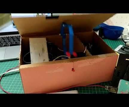

Attach a hand on the Servo Motor which will turn and turn the lights off. I used Legos as the hands because it is easy for me to get. Glue the hand onto the Servo Motor and position it on the switch so it can turn off the light when it rotates.
Position the Servo Motor to the switch, so when it rotates, it can turn off the light.

Step 5: Box
Now that everything is almost done, put everything into a box so it looks good and is tidier. It can be any box, as long as it fits everything.
If you were wondering about how to power this machine, I used my computer, connecting a wire to the Arduino Board to my computer.
Ignore the holes in my box, I used a recycled box I found. But you could also cut a hole for the sensor or other wires.
