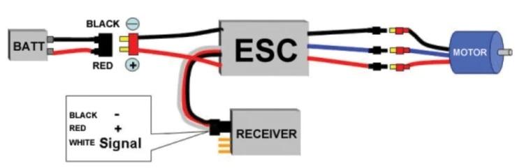

  4. Brushless Motor
  5. Choose a motor suitable for lightweight aircraft, such as a 2205 or similar.
  6. Electronic Speed Controller (ESC)
  7. 20A or 30A, depending on your motor's specifications.

  12. RC Transmitter and Receiver
  13. A 4-channel RC system will work fine for this project.
  14. Battery
  15. A lightweight LiPo battery (e.g., 2S or 3S with 800–1500mAh capacity).

  8. Connect the ESC (Electronic Speed Controller)
  9. Connect the ESC to the motor by plugging the three wires from the ESC into the motor’s connectors.
  10. Ensure the connection is solid and secure, as the motor will require stable power for reliable performance.
  11. Secure the ESC in Place
  12. Mount the ESC inside the fuselage, ensuring it is far enough from the moving parts (like the servos) to avoid interference.
  13. Secure the ESC with hot glue or tape to prevent it from shifting during flight.
  14. Wire the ESC to the Receiver and Battery
  15. Connect the ESC to the receiver (throttle channel) to control the motor speed from your transmitter.
  16. Attach the battery to the ESC, ensuring the correct polarity (positive and negative connections). Secure the battery with velcro or tape to keep it in place during flight.
