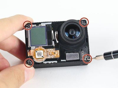

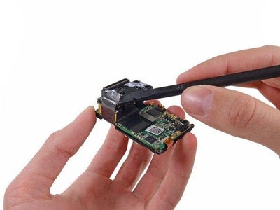

Disassemble GoPro
First you want to disassemble the camera, in my case, I used an old GoPro Hero 3 Silver Edition I found lying around. Using the T4 torx bit and screwdrivers I had, I was able to disassemble the GoPro down to the motherboard and camera sensor. Note: Photos are from IFIXIT and IFIXIT has a very thorough guide on how to do this:(https://www.ifixit.com/Teardown/GoPro+Hero3+Teardown/12457)

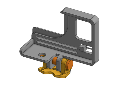

After disassembling the GoPro, I used a pair of calipers to accurately measure the sizes of parts and location of them, such as how big the recording button is and where it's located on the motherboard relative to other parts. Then, using those measurements, I began designing a case and mount for the electronics. I eventually came to my final design after 6 iterations (My first design for a case is provided in the picture). I designed the parts in CAD software, so anyone can recreate this project with just a computer, but the specific files for the GoPro Hero 3 are provided. The mount I used was designed for the specific 3-inch FPV drone I'm using, the DarwinFPV BabyApe drone. Then, I designed the case around the idea of being lightweight because I wanted to mount this to a 3-inch drone, one with less power than traditional 5-inch FPV drones.
Diving into the specifics about the case and mount, I first traced the outline of the top of the drone, using it as a reference for the mount. I then added two support arms on either side of the mount to allow the camera case to rest on. Next, I added holes going through both arms so that a pin could be inserted, keeping the camera case in place as well as another locking pin going through the main pin to keep it from slipping. As for the case, I began by taking a picture of the motherboard and tracing it. I designed a simple box with a button to enclose the camera, but this, however was heavier than what I wanted. So over time and throughout different designs, I was able to reduce to weight significantly while still keeping the strength of the original box design.

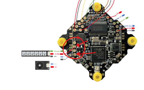

Solder to the Drone
I then soldered the wires coming from the camera to their respective places on the drone flight controller (shown in photo). In the flight controller diagram, I have circled as well as pointed to the pads I used (5V and GND) with the red wire going to 5V and the black wire going to GND. After soldering, I made sure to power on the drone and make sure the camera was receiving power too as well as being able to record.

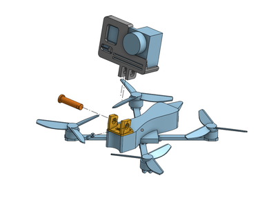

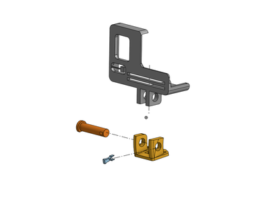

Fully Assemble
After testing that everything works, simply put the camera onto the mount. I rested the case on the mount, then lined up the holes and put the main pin inside. Then, I put the second pin in and finished the build. The exploded view (picture) provided may help with understanding what goes where.
