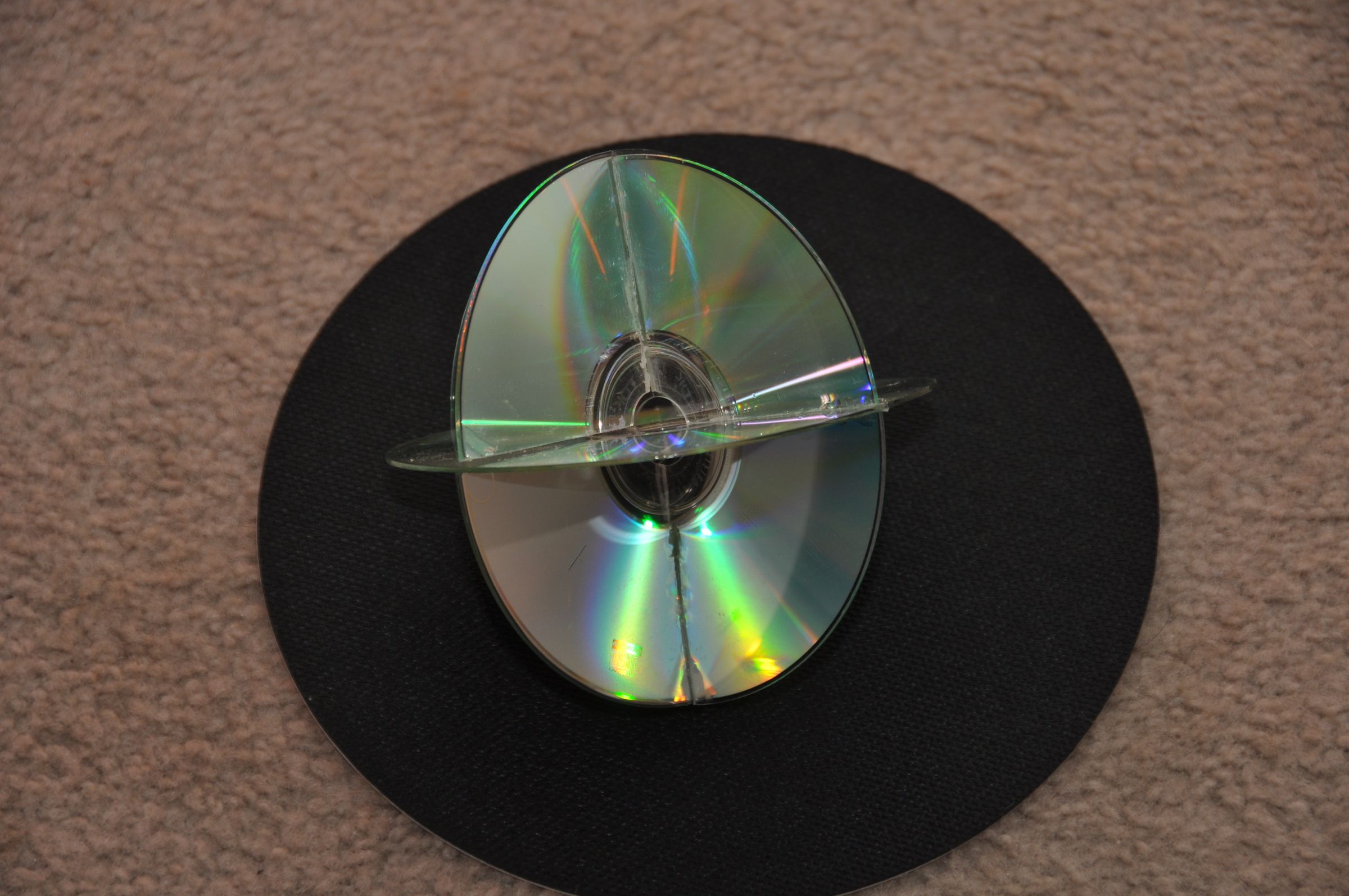

You may see smaller but simpler versions done with CDs here: http://Instructable on how to make a reflector using CDs CDs are easier but their smaller surface makes them marginally OK for the purpose. You can use the one here for situations where you know you want a larger one.
