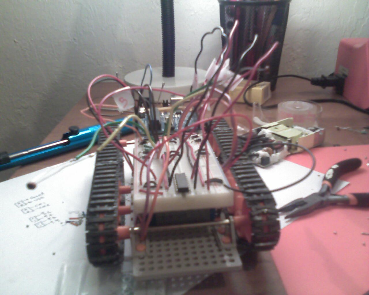

Introduction: Ligth Follower Arduino Based Robot
This is my very first robot, a ligth follower Robot
1. Tamiya caterpillar kit
2. Tamiya twin gearbox
3. Arduino Diecimila
4. H bridge L293e
5. 8 Diodes
6. Bread board
7. 2 Photo resistance
8 lot of wires
the Source Code:
