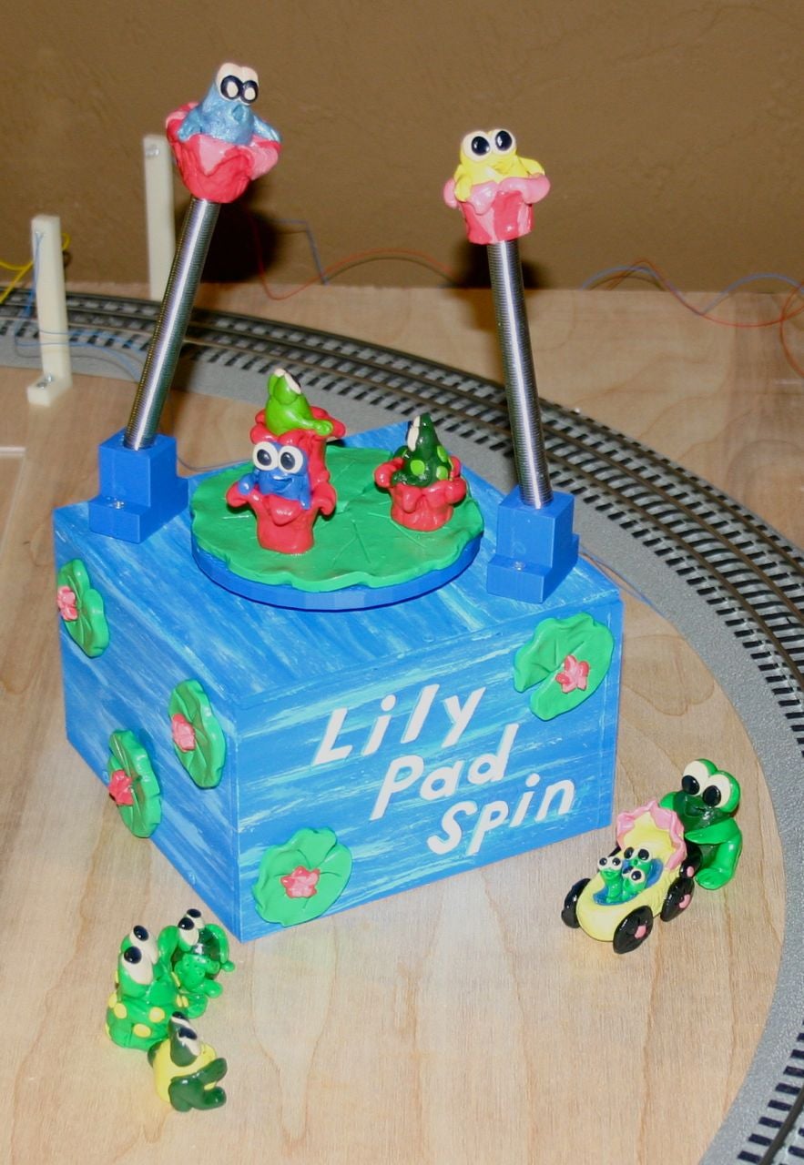

Lily Pad Spin is another ride in Froggy World, the amusement park for adventurous frogs.
This ride, designed by my wife, is for the "family" frog.  Mom, pushes a stroller of tadpoles while Dad manages the older siblings.  Frogs have a choice of riding the "spin" or sitting atop the bouncing spring.

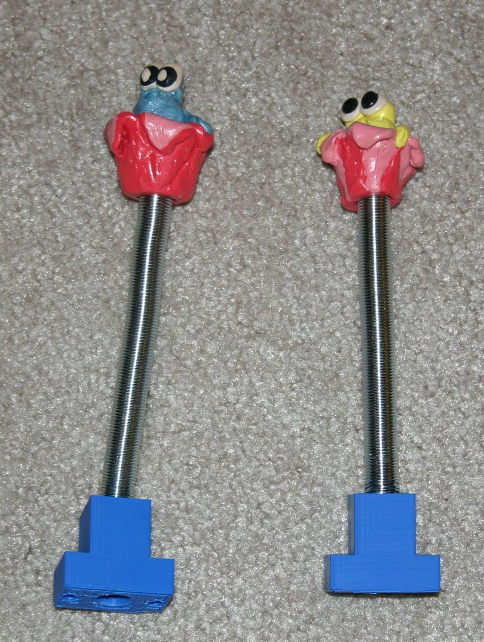

Mechanical parts--motor holder, spring holders and lily pad rotating base were 3d printed, files here:

Step 1:
Start with the printed base and add a Jameco (#155821, jameco.com) gear motor.  This press fits in the base.
Step 2:
Using 4 inch by 6 inch by 1/4 inch plywood, I glued together the sides of a box.
Step 3:
Add two pieces of 1/2 inch plywood (one for the bottom, one to elevate the motor).
Using wood screws, mount the motor.
Step 4:
Make a top using 6 inch by 6 inch by 1/4 inch plywood.  Cut a large hole in the center.  Fasten this with two small screws.
Paint the box.
Step 5:
Title the ride and add baked clay lily pads.
Step 6:
Place the 3d printed "wheel" on the shaft of the Jameco motor.
Step 7:
Make a lily pad and frogs using clay.  Bake the frogs.  Glue the assembly to the rotating base.
Step 8:
Take a .44 inch by 10.25 inch by .04 inch spring and cut it in half.
Insert each half in a 3d printed spring holder--tilting the spring at an angle.
Glue clay frogs on the ends and screw the holders to the top of the box.
Step 9:
Make and bake Mom and the tadpoles.
Step 10:
Make and bake Dad and the two kids.
Step 11:
Apply 9 volts to the motor and let the ride commence!
