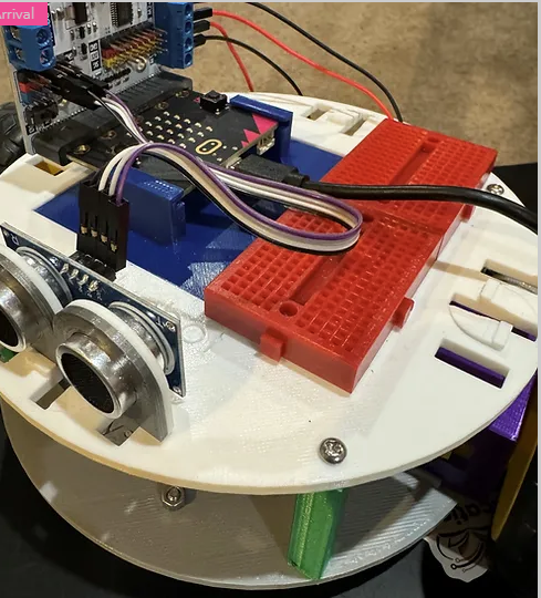

Step 4: Attach 3.3V Sonar With Mounting Module
Insert the 3.3V sonar into the sonar mount with the prongs sticking up and the arrow head ticking down as shown in the following image.
Insert sonar mount into front of upper chassis so that it locks in by turning counter clockwise. The front of the robot is closest to the words Lily∞Bot.
insert 3.3V sonar into sonar mount with pins pointing up
Drop sonar mount into front of upper chassis facing to the robot's right
Turn the mount counterclockwise until it locks in place.
Step 5: Use Schematic to Wire Sonar and Motors to Crickit and Circuit Playground Express Wiring for the Sonar to the Crickit and Circuit Playground
Wiring for the sonar to the Crickit and Circuit Playground Express and Motor to Crickit (see Fritizing schematic for more details)
  1. Sonar VCC to Crickit 3.3V Header (use male-female wire)
  2. Sonar GND to Crickt GND Header (use male-female wire)
  3. Sonar Trig to Crickit Pin 2 Header (use male-female wire)
  4. Sonar Echo to Circuit Playground Express Pin A3 (Use alligator-male wire)
  5. Connect right motor red wire to Motor 1, black wire to Motor GND
  6. Connect left motor red wire to Motor 2, black wire to Motor GND
