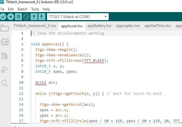

Plug in your watch, start Arduino IDE, Select the watch on the Board section, open a sample application in the TTGO section of Examples (try SimpleWatch in the LVGD section), compile and download. Hopefully all went well and your watch is ready to be programmed.
Step 3: Load the Framework and Add Your App
Download the Arduino Framework code in the individual INO files in this Instructable (sorry, I could not get the zip file to be accepted by Instrucables). Place them all into a folder in your Arduino sketch folder (Name the folder something you will remember). Open it in the IDE (may have to restart the IDE).
You will see that there are a bunch of separate tabs to the program. The Main tab is labeled TWatch_Framework_0. It is where the setup() and loop() subroutines are. The other important tab is the Menu tab.
If you have verified you can download the examples to your watch, you should now be able to download this to your watch.
To add your own app to this watch do the following:
1) In the Menu tab you will see the code:
const int maxApp = 6; // number of apps
String appName[maxApp] = {"Clock", "Jupiter", "Accel", "Battery", "Touch", "Set Time"}; // app names
Increment the constant maxApp by 1. This is the total number of apps.
Append the name of your app to the appName string array. It can be inserted anywhere. But be advised, the menu function returns the number of the selected app. It has to match the switch-case to select the correct app.
2) In the Main tab, add a call to your app as a case in the switch statement in the main loop().
switch (modeMenu()) { // Call modeMenu. The return is the desired app number
case 0: // Zero is the clock, just exit the switch
break;
case 1:
jSats();
break;
case 2:
appAccel();
break;
case 3:
appBattery();
break;
case 4:
appTouch();
break;
case 5:
appSetTime();
break;
}3) Add a tab, and write your code as a subroutine or function that is called from the case statement. See the appTouch tab as an example.
That is it. With the tabs I have already, you should be able to quickly code a new app that can be called from the menu. Take a look at the methods I use to exit apps. You want to make sure that the user is not pressing the touch screen when the app exits or you will immediately go back to the menu instead of the time display.

ttgo->tft->drawNumber(mm, xpos, 35, 7);
// Display Battery Level
ttgo->tft->setTextSize(1);
ttgo->tft->setTextColor(TFT_YELLOW);
ttgo->tft->drawString("Power", 124, 2, 2);
ttgo->tft->setTextColor(TFT_GREEN);
int per = ttgo->power->getBattPercentage();
ttgo->tft->drawString(String(per) + "%", 179, 2, 2);
ttgo->tft->setTextColor(TFT_GREENYELLOW);
ttgo->tft->drawString(String(dday), 50, 188, 6);
// Turn off the battery adc
ttgo->power->adc1Enable(AXP202_VBUS_VOL_ADC1 | AXP202_VBUS_CUR_ADC1 | AXP202_BATT_CUR_ADC1 | AXP202_BATT_VOL_ADC1, false);
// Draw Month
String mStr;
switch (mmonth) {
case 1: mStr = "Jan"; break;
case 2: mStr = "Feb"; break;
case 3: mStr = "Mar"; break;
case 4: mStr = "Apr"; break;
case 5: mStr = "May"; break;
case 6: mStr = "Jun"; break;
case 7: mStr = "Jul"; break;
case 8: mStr = "Aug"; break;
case 9: mStr = "Sep"; break;
case 10: mStr = "Oct"; break;
case 11: mStr = "Nov"; break;
case 12: mStr = "Dec"; break;
ttgo->tft->setTextColor(TFT_WHITE);
ttgo->tft->drawString(mStr, 9, 194, 2);
// Build a bargraph every 10 seconds
int secmod = ss % 10;
if (secmod) { // Show growing bar every 10 seconds
ttgo->tft->fillRect(126 + secmod * 10, 215, 6, 15, TFT_ORANGE);
} else {
ttgo->tft->fillRoundRect(119, 210, 120, 29, 15, TFT_DARKCYAN);
