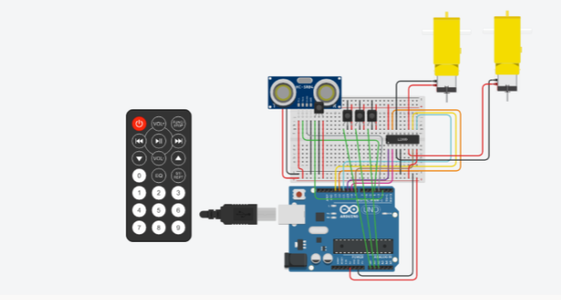

Step 1: Wiring
Wire the breadboard with the UDS, line sensors, motor drivers, motors, and battery as shown in diagram.
