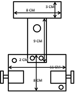

The BODY (look at the picture):
The base of the robot is made of PCB cutted to the properly size.
You will also need 5 screws:
- 2 for putting together the front and the base of the robot
- one for lifting the sensors off the ground (you can use something else here, if you have)
- 2 for lifting and fixing the microcontroller PCB
