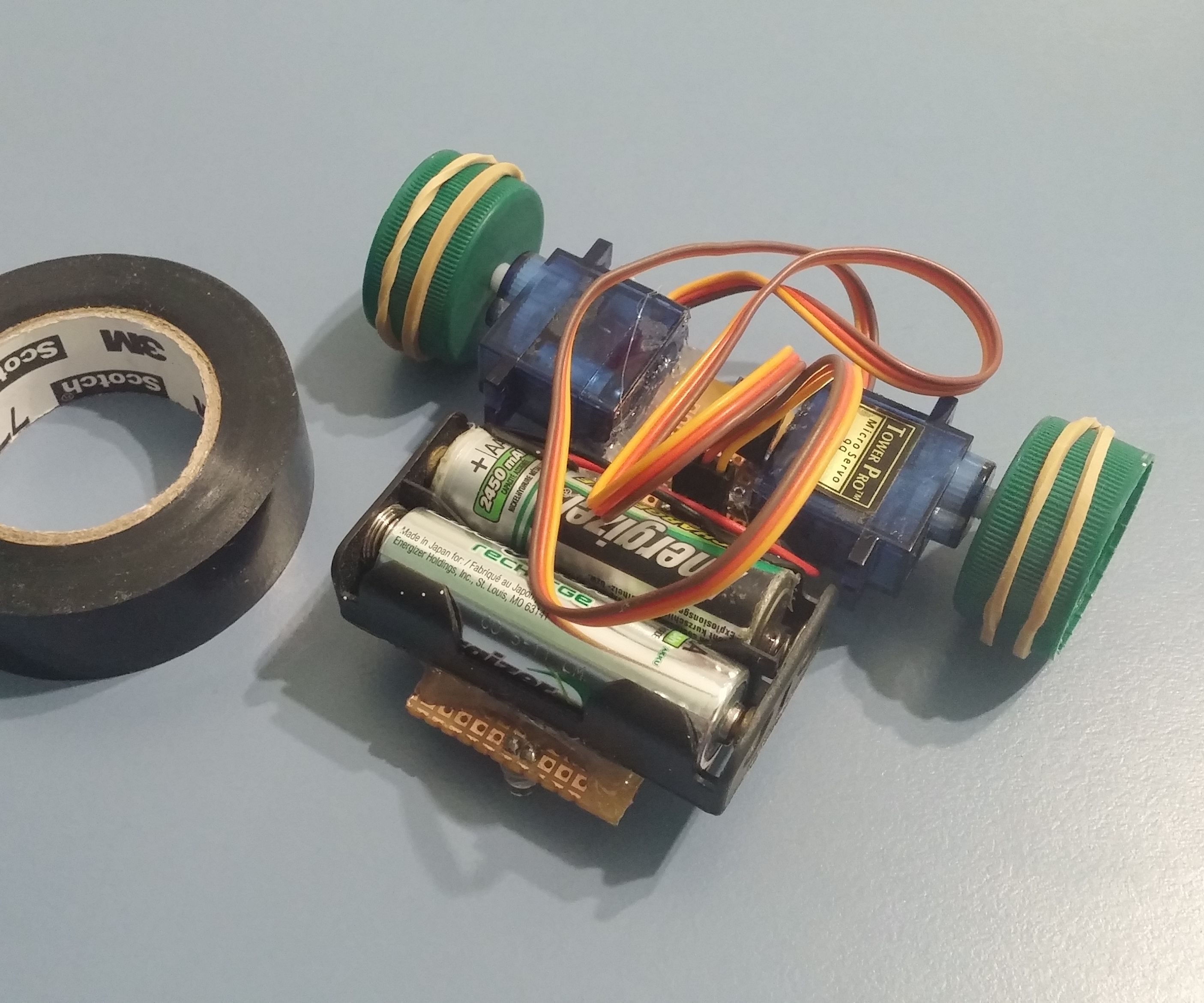

Step 4: Making the Structure
The method I chose for making the base of the robot was 3D printing. It allows me to make several iterations of the design and test what works best. Also, the plastic is very light but strong enough for this application. If you want you can make this part out of any material you want since it is a very simple part and easy to make or design, just take care of all the dimensions and distances, so that everything fits. I designed 2 parts, one for the main body of the robot and another for holding the sensor. This allowed me to print 2 sensor holders of different lengths and change them if a track at a competition is particulary difficult and I need to put a shorter sensor holder to have more maneuverability. You can find my designs at this Thingiverse post and I encourage you to design your own or modify mine to your liking: 3D printed base
Step 5: Assembly: Motors, Wheels and Battery
At first you need to solder some cables to the motors. I found that cutting a dupont cable in half is perfect for soldering each half to a pin of the motor.
The motors are attached to the base with 1/8 inch screws and with the 3d printed bracket linked at the beginning, but you can also buy a motor bracket if you adjust the holes in the design of the base.
For the wheels, I found that I could get a lot of traction by making my own covers out of silicone. What I did was use the wide Pololu wheels, took the black cover out, 3D printed a little cup 45mm in inner diameter, put the white plastic part of the wheel in the cup and filled the exterior with molding silicone. In this way I had the plastic part sorrounded with silicone, and when it finished hardening I had my high traction wheels. If you want to make this you have to make a cup about 40 or 45 mm in inner diameter and hold the plastic part of the wheels in the middle. Make sure it is in the EXACT middle! Then you should pour the silicone. This is silicon used for making the molds but here I used it for the molded part itself. Beware of having the plastic part loose because it may float and you want it to be perfectly parallel to the plane of the wheel.
The wheels go pressed gently into the motor shaft, taking care to align the D shaped hole with the shaft, and the pressure will keep them secure in place.
In my design I took into consideration the dimensions of my battery and so it fits tightly between the motors, make any modifications needed to the base if your battery needs more space or if it is smaller and you want a more compact robot. The battery is simply held by the components around it and the cable connection. Since this robot doesn't shake, vibrate, or bump into stuff, the battery won't jump around and there won't be too much tension on the battery cable.
Step 6: Assembly: Arduino and Shield
The Arduino should be screwed to the base and then the Shield needs to be inserted on top of it. I found that 2 screws could very easily hold the Arduino but you can add up to four if you modify the base. You should then connect to the shield the 2 motors and the battery, the sensors will be connected later. The USB port in the Arduino should be facing to the back of the robot since we will be connecting to it when we program the robot.
Step 7: Assembly: Sensor Board, Ball Caster and Sensor Holder
Now that we have the base completed, we need to attach the sensor holder which holds the sensor board and a ball caster that provides a low friction support to the robot.
The sensor holder is screwed to the base in two points and then the sensors and the ball caster are screwed to the sensor holder with 2mm screws. If you want you can now attach a 6th sensor to the holder and connect it to the main sensor board. Now we have to connect the sensor board to the shield with 8 dupont cables. In the design of the sensor holder I made a hole through which the cables can pass but that is just for convenience.
We have now finished assembling the robot. If you already have all the parts ready, the whole assembly takes between 15 and 20 minutes, and maybe a little bit more if you are unexperienced with tightening screws and connecing electronics.
