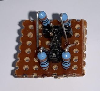

4 x 330R resistors for the interface adapter

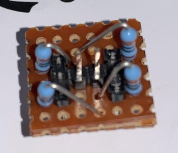

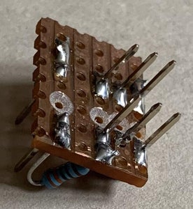

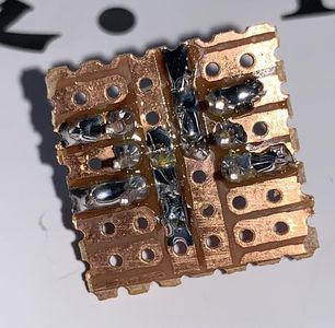

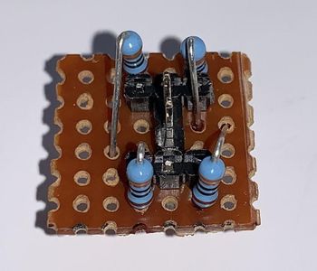

Step 11: Make the Upgrade Adapter
The point of this is to interrupt the circuit between the IC and the motor switch transistors so that an alternative control signal can be inserted. The small circuit contains 4 resistors together with PCB pins to secure it in the sockets that were fitted earlier and to provide a connection for the L0cost Robot Controller later. This mod works fine to run the kit as a line follower but problems with the ESP32 boot means that it needs a hardware fix to do seamless cutover from remote to automatic which I haven't developed yet. A later step describes a remote control insert.

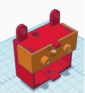

Several 3D printed parts are use to adopt the upgrades. A mount is fitted to the front of the PCB using the skid bolt, and an adapted L0Cost Robot Battery Box is used to provide power. The battery box is described in this instructable and the adapter matrix board for the controller is described in this instructable here.
Attached are the .stl file for the 3D printed parts but they are also shared on TinkerCAD at the following links.

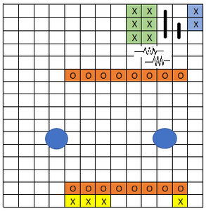

As well as the extra plastic parts, a matrix board for the camera is needed and a small adapter board for the remote control function. This small adapter has two lines of three connector pins with a fourth pin in line to which the controller connects. A 330ohm resistor connects this to the motor pin on each side. See picture.

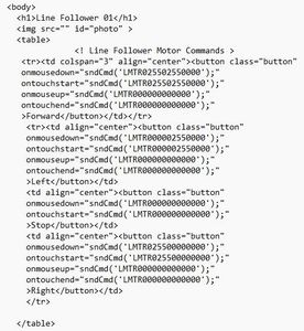

Step 19: Customise the SDcard Contents - Html
For web based control and viewing, the controller publishes a home page defined in config.txt. A copy of this can be downloaded from the Github repository, along with all the other SDcard files.

  1. Switch off the robot, if it's still switched on, and remove the small adapter matrix board fitted earlier.
  2. Fit the remote control matrix board to the PCB, making sure all six of the lower connector pins it into the socket.
  3. Using two female to female dupont patch leads, connect the two pins on the top of the remote control board to the control pins on the controller board. They are the bottommost pins in the set of six next to the power pins.
  4. Switch on the robot and if it appears to burst into life, should become dormant very quickly. Wait until the controller web site is available and connect to it.
  5. The basic web page supplied can be used to steer the robot remotely. If the directions are reversed, swap the dupont lead connections on the remote control adapter. If a script is written, it can be executed by the controller to direct the robot automatically.
