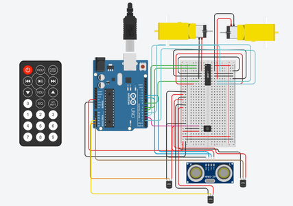

Step 2: Build the Circuit
Attached is a picture of the circuit diagram needed for the car. This step can get messy very easily, just take your time and go one component at a time. Make sure to route the cables for the ultrasonic distance sensor, line sensors, and the DC Motors through the cutouts made in the previous step.
The motor driver on the diagram is not the same motor driver we used on our car. Also, The line sensor is not available on tinker cad the software used to make the diagram so temp sensors are used and are wired how the line sensors should be wired.
