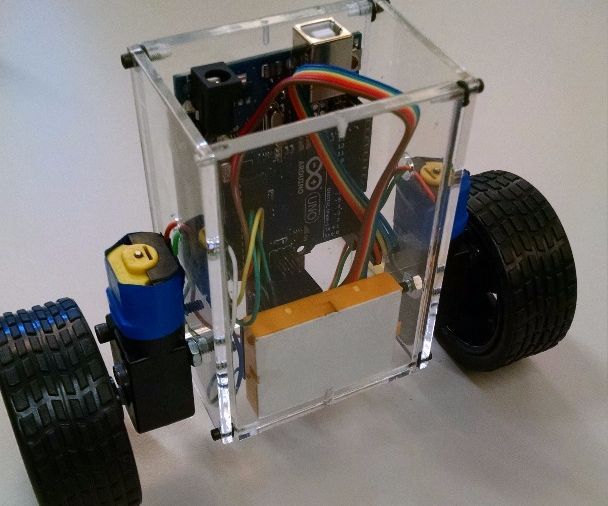

A simple body was designed to be cut from 1/8" acrylic using a laser cutter. Solidworks and vector schematics are available below. The body of the robot was designed around the components it was required to fit, therefore the width of the body was determined largely by the width of the servos used for the wheels, and the length was chosen to fit both the Arduino Uno board, servo battery pack and Arduino battery. It was decided to use a simple hardpoint for the rear pivot, in the form of a 1/4" button head bolt, because the robot was designed to run on a flat, hard surface, which was not anticipated to pose problems to such a simple method of rear support.
Step 3: Robot Assembly
The robot body was cut on the laser cutter using the files in the previous step. The body was then assembled using superglue, and the servos were installed. The rear bolt was installed, and the AA battery pack for servo power was attached. The photoresistors were attached to the front of the robot body, mounted on lengths of cat5 cable such that their position was easily adjustable and stable.
