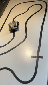

Step 1: Track
The robot is designed to read a black line of a thickness of 15mm. Using regular A4 paper and a standard printer, you can print a black line of 15mm to create a track. Additionally, the robot should be able to continue forward when facing intersections. You can include those in your track design as well.
Other methods can be used to create a track to your liking. I have noticed that black electrically insulating tape is a perfect alternative. Since the tape has some elasticity, you can manipulate it to make clean corners by stretching. The pictures above show handmade tracks using only electrically insulating tape on a white desk. Beware, the contrast between black and white should be as high as possible for the robot to be able to detect the black line effectively. You can use all your creativity when designing your track! Enjoy!

Step 9: Testing
The robot should be able to complete a full lap of your designed track using only following parameters: Power, Kp and Diff. I would recommend starting off easy with following parameter values:
-         Power -> 50
-         Kp        -> 10
-         Diff      -> 0,5
If the robot is successful in completing multiple rounds without stopping, you can continue to increase Power and Kp. Have fun in this phase! I encourage you to mess around with all parameters and see what happens! For example, give Kp an extreme value of 150 and observe how the robot behaves.
