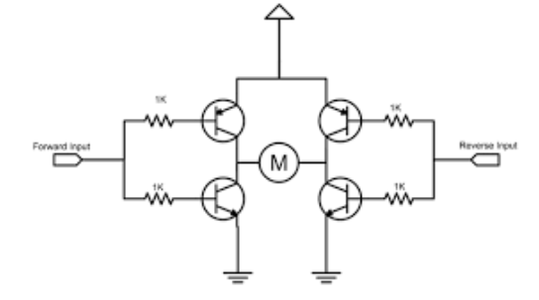

Step 1: Build Two H Bridges on Breadboard
Using the following schematic of one H bridge, build two H bridges on your breadboard
Step 2: Connect Motors
Connect Motors to the H Bridges by connecting the collector of the PNP transistor to one end of the motor and the collector of the NPN transistor to the other end of the motor. Repeat for both H bridges
