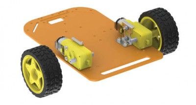

Step 2: Making the Base Robot

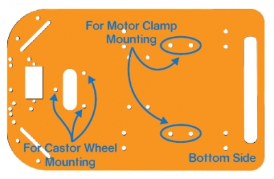

Take a base plate or chassis.
Mount two motor mounts using M3 bolts and nuts.
Onto these motor mounts, attach Dual Shaft DC Motors.
Once you mount the motors, fix the wheels onto the free shafts.
For any robot to get stable, we will be needing third support. Thus, we will be adding a caster wheel to do the job.
Flip the assembly. Thus, our base is ready.

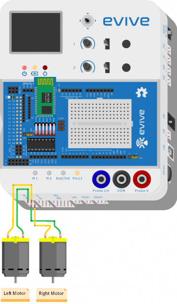

Step 5: Connections
Make the connections as shown in the given figure:
