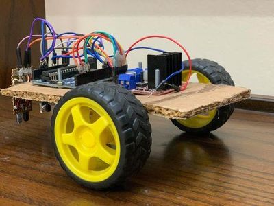

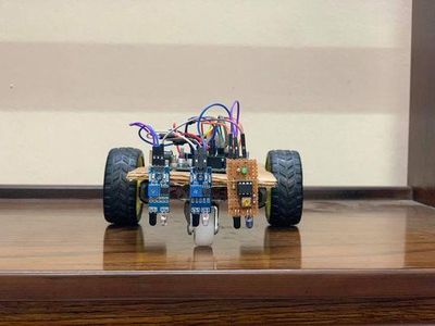

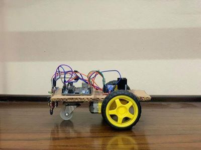

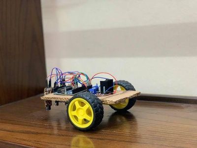

Step 1: Preparing the Chassis
First attach the motors to the Chassis.
Then attach the wheels with the motors. After doing attach the caster wheel to the front of chassis. Now your chassis is ready.
But if you don't have any chassis then you can use any type of cardboard or plywood or PVC pipe sheet and then you can attach the motors and caster wheel to it.

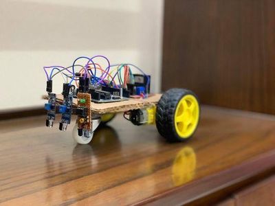

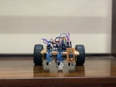

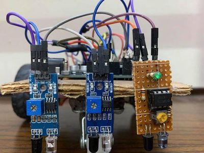

Step 2: The Upper Part of the Chassis
First attach the proximity sensors to the front of the chassis facing downwards
  • Left sensor to the Left Corner of the Chassis.
  • center sensor to the Center of the Chassis.
  • Right sensor to the Right Corner of the Chassis.
If you are having problem look at the picture.

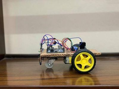

Attach the Arduino Uno to the Middle of the Chassis.
Attach the Motor Driver to a little back of the Arduino Uno.

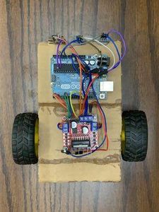

Step 3: Connections
This is a important part of the project. Now I will describe the connections to you
Left sensor >> Arduino Uno
  • VCC >> 5V
  • GND >> GND
  • OUT >> 7
Center sensor >> Arduino Uno
  • VCC >> 5V
  • GND >> GND
  • OUT >> 8
Right sensor >> Arduino Uno
  • VCC >> 5V
  • GND >> GND
  • OUT >> 9
L298N >> Arduino Uno
  • EA >> 10
  • IN 1 >> 2
  • IN 2 >> 3
  • IN 3 >> 4
  • IN 4 >> 5
  • EB >> 11
  • 5Volt >> 5Volt
  • GND >> GND
Give 12Volt to L298N's 12Volt.
Here is the link to the circuit diagram:- CIRCUIT DIAGRAM

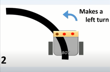

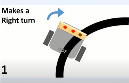

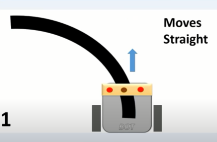

Step 4: How It Works
Now I will show you how my Line Following Robot works. (//I am usingProximity sensors withActive High Output//)
To Go Straight:
  • When the Centersensor will detect black line.
  • The two other sensors will detect white surface.
  • The two Motors will go clockwise/right.
To Go Left:
  • When the Leftsensor will detect black line.
  • The other two sensors will detect white surface.
  • The Left Motor will stop.
  • The Right Motor will go clockwise/right.
To Go right:
  • When the Rightsensor will detect black line.
  • The Right Motor will stop.
  • The Left Motor will go clockwise/right.

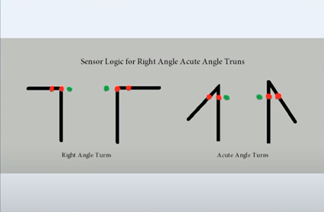

To Go 90 Degree Left:
  • When the Center andLeftsensors will detect black line.
  • The Right sensor will detect white surface.
  • The Right Motor will goclockwise/right.
  • TheLeft Motorwill go counter clockwise/left.
To Go 90 Degree Right:
  • When the Center andRight sensors will detect black line.
  • The Left sensor will detect white surface.
  • The Left Motor will goclockwise/right.
  • TheRight Motor will go counter clockwise/left.
To Go 40 Degree Left:
To Go 40 Degree Right:
To stop:
  • When all thesensor will detect black line.
  • The two Motors will go stop.
In this way this Line Following Robot will work. It has 90 Degree and 40 Degree turns and it can also detect 90 Degree and 40 Degree lines. This is full description of how this robot will work.
