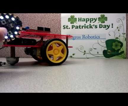

Here are a couple short videos of the robots maneuvering under the conditions we suggested previously :
