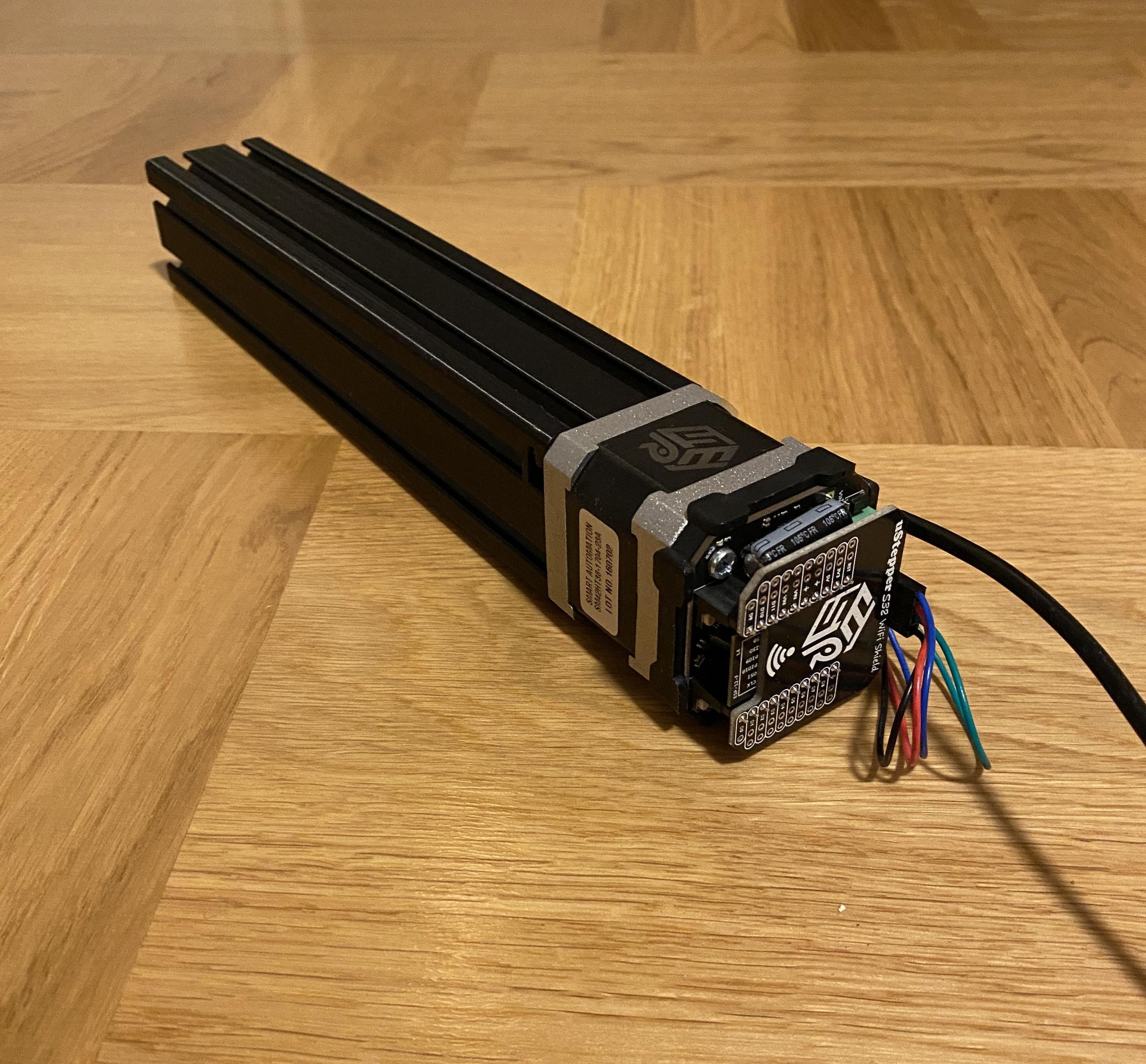

This instructable gives a short walk-trough of my linear actuator design. The idea of this design is to keep it relatively simple, keep the cost relatively low and make a well functioning actuator !
The Actuator is driven by a NEMA 17 motor and in my case using uStepper S and egoShield S to make it fully stand-alone.
Step 1: Drawings, Instructions and BOM
I have done a bit of effort to put together a BOM and build instruction in a PDF here. It should pretty much explain everything regarding the mechanics. Also a package with STL files is to find here as well as a STEP file for the complete design - making it possible to adjust for your specific needs.
Printing of the parts was done in PLA with 0.2mm layers, 50 % infill and support where needed.

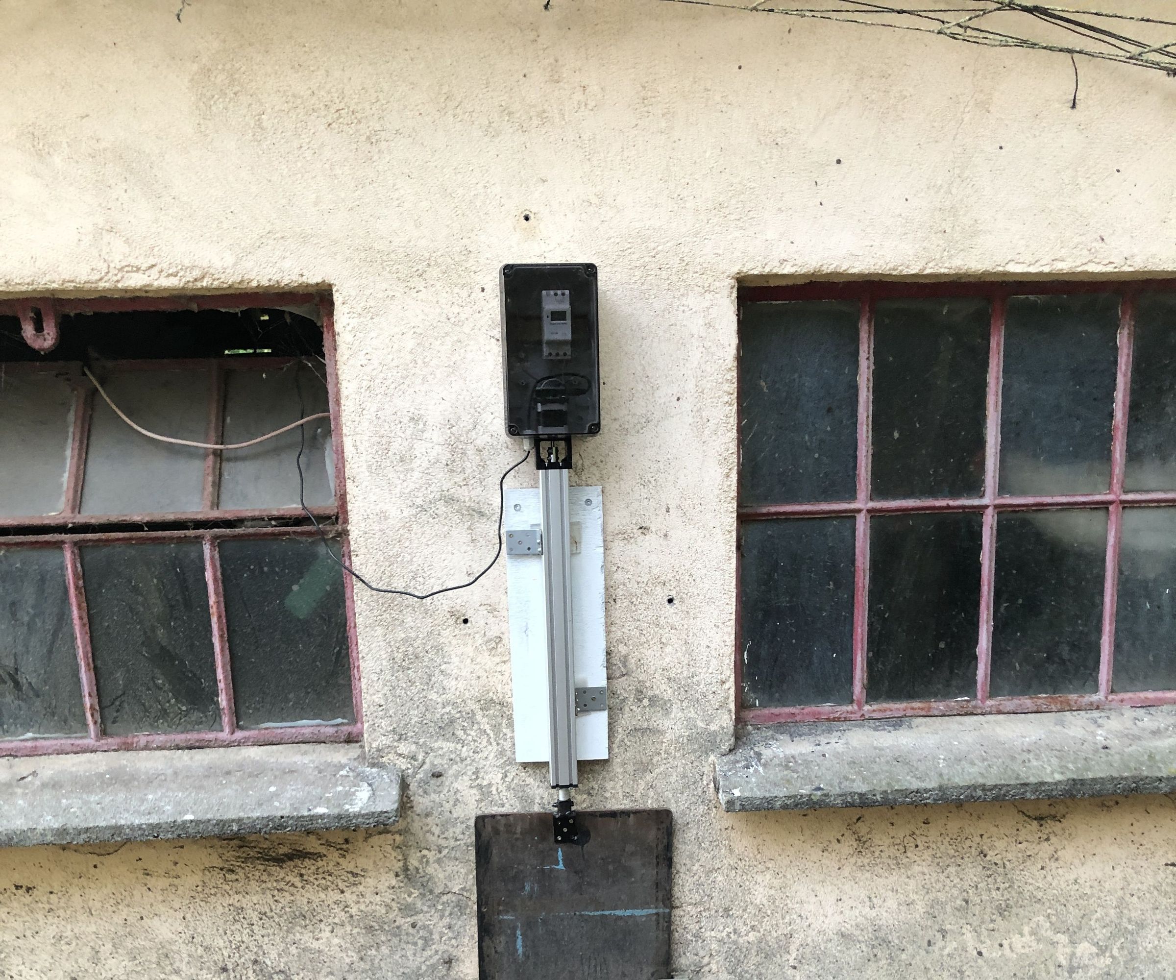

A video showing a test of a random motor I had lying on the shelf shows that the 12 Kg weight of that motor is not a problem for the linear actuator :)
