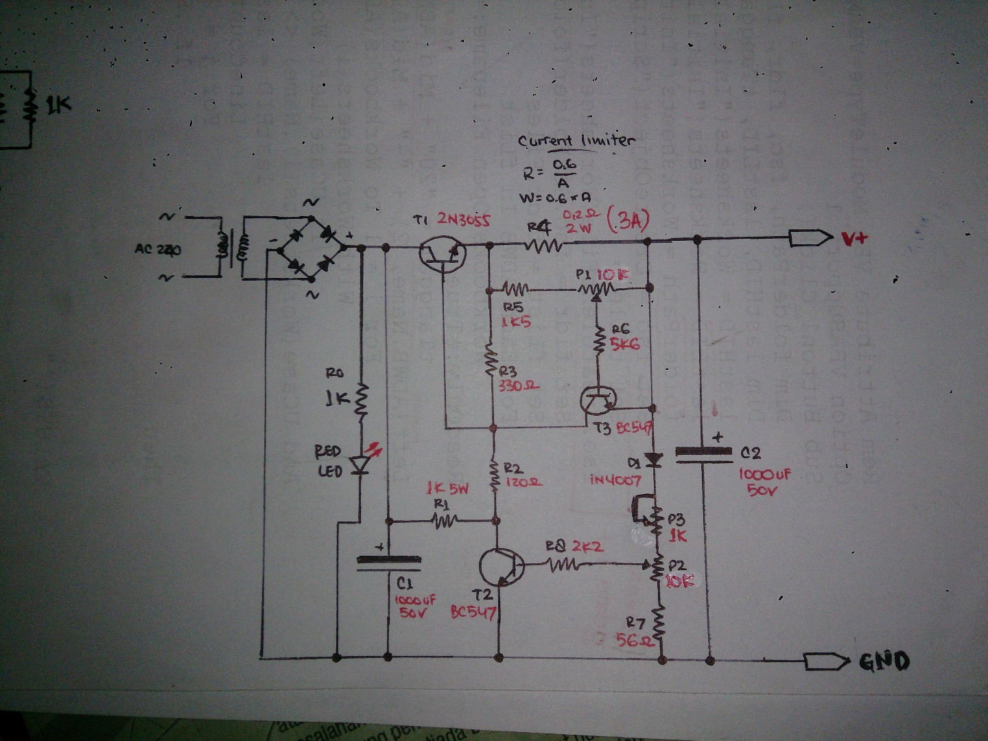

I replaced the whole circuit and turn it into a 2.2V to 14V Linear Adjustable Voltage Adjustable Current Power Supply. The circuit I used is taken from Homemade Circuit Projects so credit goes to Swagatam Majumdar.

This is the circuit posted in Homemade Circuit Projects.
Then I redraw it into my version :

Well, for the resistors if you can't find the exact value of the resistor or wattage, you can use some in series or parallel to get the closest value as needed in the circuit diagram.
