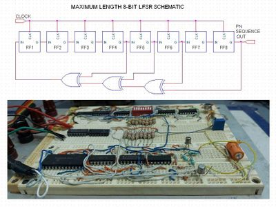

This is revisit of a student project I mentored back in 1990-91. Surprisingly the breadboard hardware which was recently returned to me and had not been powered for 30 odd years worked perfectly when powered ON.
This project implements a pseudo-random (PN) sequence generator based on a 8-bit linear-feedback shift register (LFSR). Additional circuitry was added to convert and send the 1's and 0's output of the LFSR as ASCII serial data '30','31' Hex. This permitted acquiring and analyzing the output stream using a simple dumb terminal.
A 8-bit DIP switch permits setting up of desired feedback combinations from the eight shift register outputs. Generation of different length PN sequences including the maximally long LSFR could be demonstrated and compared with calculated results.

Step 1: Circuit Schematic
The circuit is implemented using standard TTL devices a 555 timer and an ULN2003 open-collector driver.
The 555 timer sets-up the primary clock at 2400 Hz. This clock is fed to the 74LS93 4-bit binary counter. QD of the counter when inverted forms the clock to the 8-Bit shift register 74LS164.
The eight outputs of the shift-register are connected to ex-OR gates through DIP switches. Effectively the connected switches are ex-OR'ed to form the feedback input to the shift-register. The resistor network sets the Low value for unconnected er-OR gate inputs, as open TTL inputs are considered as H.
The LFSR scheme has a drawback that no sequence is generated if the seed is all zeroes. The UNL2003 along with two OR gates forms an 8-bit OR gate which ensures that a High state is input to the shift-register if all the outputs are zero.
The 74LS154 4 -16 line decoder inputs are connected to the QA-QD outputs of the 4-bit binary counter. The decoder outputs Q4-Q14 are the basic 10 counter clock periods used for the serial output generation.

Step 2: Test Results
The first two slides show raw data captured on a PC using a USB to serial converter. Data is displayed in ASCII '0101...' or alternately as Hex s '30 31 ...'
Three test cases with the corresponding DIP-switch positions are presented along with the experimental data and and predicted using the OMNI LFSR calculator. https://www.omnicalculator.com/math/linear-feedback-shift-register.
Switch 10101100 Period 6
Expected 110011

Switch 10111000 Period 255
This is a maximally long LFSR.
