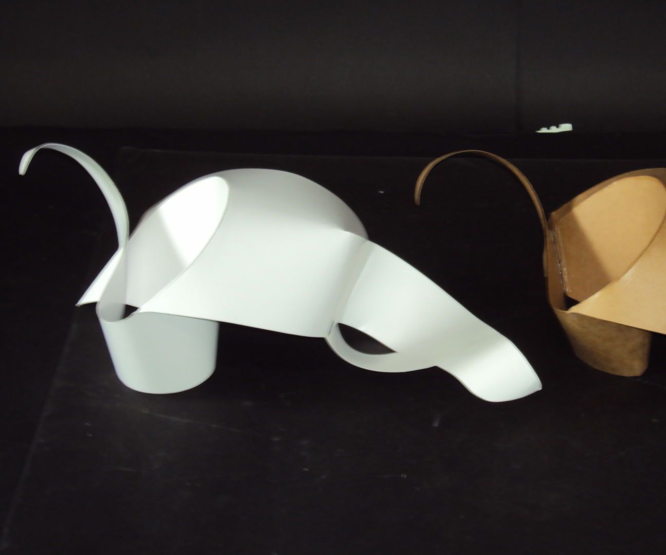

Step 4: Explorations in Paper
Cut 1mm strips of White Card sheet and Ivory sheet and just explore keeping your keywords in mind. Some worthwhile explorations will come out.
After making 10- 15 explorations, choose the exploration which best conveys the meaning of the keyword. Try playing with it in different materials.
I have used 0.5 mm MS rod for an exploration and mounted it on an MDF board as base. In another, MS strips(1mm) in width have been mounted on a glass base and attached with Araldite. Similarly, Polystyrene strips have also been used to make a form.
