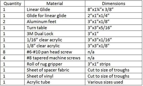

Step 1: Materials
Gather all necessary materials depending on whether you are making the small
or larger version. Use the charts shown at your own discretion as particular parts may be substituted. Most parts you can find at your local hardware store or craft store. However, the linear glide and turntable need to be ordered from these specific vendors:
Turntable: http://www.mcmaster.com/#6031k16/=vxr170
Linear Glide: https://www.sugatsune.com/product/mini-guide-block-and-rail/

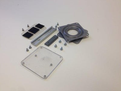

Step 3: Fabrication of Parts for Assembly
Larger Assembly:
  1. Cut pieces of acrylic to size, both 1/16” and 1/8”. They should match the dimensions of the turn table, 3”x3. Make corners of acrylic pieces rounded using a belt sander or Dremel tool.
  2. Cut the “feet” out of aluminum, 3”x1”. If you do not have access to aluminum, acrylic can also be used. Make sure to use thicker acrylic (+1/8”) in order for it to hold a screw to be used later. Make the corners rounded using a belt sander or Dremel tool.
  3. Cut out pieces of the rug gripper material to match the size of the “feet”, 3”x1”.
  4. Drill a hole into the center of the “feet” so they can be secured to the linear glide. In our case, we used a #8 tapered machined screw that had to be grinded down to fit our exact needs. The hole was also tapped to fit this specific screw.
  5. Using the hand drill, make a small hole on either end of the linear glide in the center. The holes size should correspond with whatever you are using as a stopper. In our case, we used a #8 bolt after the whole was tapped.
  6. Take the 1/8” piece of acrylic and turn table and line them up. Mark the acrylic with a sharpie where the 4 outer holes on the turn table are. Drill these holes on the acrylic using a drill bit that corresponds with whatever type of screw you are using. Repeat the above step with the 1/16” piece of acrylic.
  7. Using the same 1/8” piece of acrylic, line up the glide in the center and mark where the two holes should be. In our example, we countersunk the acrylic so it would fit a #8 tapered screw as to not interfere with the turntable above it.

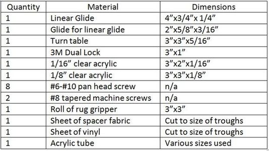

Smaller Assembly:
  1. Cut 1/8” piece of acrylic to size, it should match the dimensions of the turn table, 3”x3. Make corners of acrylic pieces rounded using a belt sander or Dremel tool.
  2. Cut 1/16” piece of acrylic to size, 3”x2. Make corners of acrylic pieces rounded using a belt sander or Dremel tool.
  3. Cut out a piece of the rug gripper material to match the size of the turntable, 3”x3”.
  4. Drill a small hole on either end of the linear glide. The holes size should correspond with whatever you are using as a stopper. In our case, we used a #8 bolt after the whole was tapped.
  5. Take the 1/8” piece of acrylic and turn table and line them up. Mark the acrylic with a sharpie where the 4 outer holes on the turn table are. Drill these holes on the acrylic using a drill bit that corresponds with whatever type of screw you are using.
  6. Using the same 1/8” piece of acrylic, line up the linear glide in the center and mark where the two holes should be.
  7. Take the 1/16” piece of acrylic and line up the glide of the linear glide in the center of the acrylic and mark where the two holes should be. Drill through the acrylic using the appropriate drill bit.

Step 5: Assemble Your Parts
Assembly for Larger Model:
  1. Attach feet to linear glide. Make sure the screws do not interfere with the glide
  2. Glue pieces of rug gripper material to the bottom of the feet using the Super77
  3. Add a stopper screw to one end of the linear glide
  4. Attach the glide to the 1/8” piece of acrylic. Make sure the screws used do not interfere with the linear glide
  5. Attach the 1/8” piece of acrylic to the turntable using the pre-drilled holes and appropriate screws
  6. Attach the 1/16” piece of acrylic to the other side of the turntable, again using the pre-drilled holes and appropriate screws
  7. Take the 3”x1” piece of 3M Dual Lock and apply it to the middle of the 1/16” piece of acrylic
  8. Insert the glide into the track and attach the second stopper screw
Assembly for Smaller Model:
  1. Glue the piece of rug gripper material to one side of the turntable
  2. Add stopper screw to one end of the linear glide
  3. Attach the turntable to the 1/8” piece of acrylic. Make sure the screws used do not interfere with turntable
  4. Attach the 1/16” piece of acrylic to the glide using the predrilled holes and appropriate screws
  5. Take the 3”x1” piece of 3M Dual Lock and cut it into 3 pieces so that it fits around the screws on the 1/16” piece of acrylic
  6. Insert the glide into the track and attach the second stopper screw
