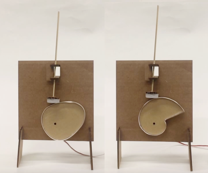

Step 5: Set a Servo Motor and a Pinion (rotational) Gear
First, attach a servo motor on the body part (part #1). You can use either hot glue or duct tape. I used duct tape here.Then make a pinion gear by attaching two layers of gear parts with a motor part (the servo “horn” that came with the motor package). After the glue has set, connect the pinion gear to the motor on the body.
A pinion gear for a continuous servo motor is missing some teeth, which allows the rack gear to drop suddenly on each full turn when the untoothed section of the gear comes around. The assembly process is same as the above.
Step 6: Set a Rack (linear) Gear
Make a rack gear by attaching two layers as in the previous step. On the side of the rack gear, attach a wood skewer and adjust the length. This helps to adjust the height when using this linear movement into other craft you’re planning. (If you don’t plan to use it in your other creation, you don’t need to attach the skewer.)
Then figure out how many of the part #3 you need to attach to interlock the rack gear with the pinion gear. In this case, I needed two layers (again, the number of layers can vary depending on the materials you’re using). Once you are sure of the right height, attach them to the body. And leave some space from the edge,...roughly 7-8mm (0.3”) would be good. This space is for attaching props later to make the body stand. The continuous servo version is same as the 180° one. Set a rack gear by attaching two layers (with a wood skewer) and attach parts to match the height of the pinion gear and the rack gear.
Step 7: Interlock the Rack and the Pinion
Turn the motor clockwise, and plan the bottomline for the rack gear’s linear motion. Attach the long thin part #2 besides the rack gear position.It will make a wall to help the rack gear move straight up and down. Once you’re sure of its path, glue the part onto the body.
Here, an additional part for the continuous servo version comes. To use a continuous servo, you need to build a ‘floor’ to place the rack gear after it drops down. Cut a small cardboard part (I used the small piece cut out from where the motor mounts on the body case) and place it at the bottom of the path. To check the correct position, set the pinion gear as shown at the right before hitting the rack gear and see if it is at the right place to interlock the rack and pinion gears as the pinion gear continues rotating counterclockwise.
Now, you need to build the other side of the wall to complete the path for the rack gear. Check whether the part #6 is slightly higher than the rack gear. Because it will complete the path for the linear movement of the rack gear, this space shouldn’t be too loose or too tight. Once you’re sure, attach it to the enclosure part #5 and repeat it with the rest using the part # 7 and 8. This process is same for both 180° and continuous servos. Once dried, place them on the path, double check if this path fits to the rack gear’s linear motion, and glue them carefully. Here you shouldn’t to attach the rack gear together.
Now you just need to set props (part #4). If you’re building with a 180° servo, you can set both vertical and horizontal directions are fine. If you’re using a continuous servo, you need to make it vertical, since the rack gear needs to drop down. Then connect the servo to the Arduino and run it.
