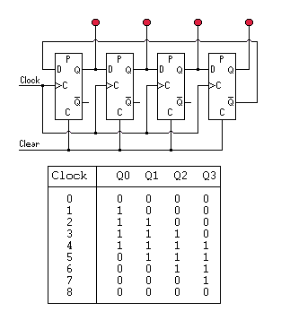

In the questions and answers forum at Instructables a fellow DYI member asked about building a liner counter. He was building a Coil Gun and he wanted a way to track the number of times he fired his Coil Gun. He wanted six LEDs, two green, two yellow, and two red LED, and he wanted them to turn off one at a time as a projectile passes between an IR LED and a Phototransistor.
I came up with a modified Johnson Counter, the counter and added the IR LED and Phototransistor to the clock.
Step 1: Modified Johnson Counter

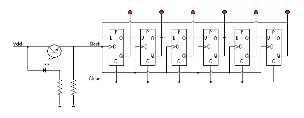

As in most circuit simulator programs, what works in the program does not necessarily work in the real world. Since I have over 100,000 components at my disposal I offered to build and test the circuit on a bread board.
Step 2: This Is the Finished Circuit
I built and tested this circuit a number of different ways using SN74LS74 and SN74LS175 ICs, With SN74LS175 ICs the circuit is smaller and uses 2 ICs less and half the wires than building it with SN74LS74 ICs.
This is two different ways to wire the circuit.
It works the way they wanted, turn on the circuit and all the LEDs turn on, if all 6 LEDs do not come on press the reset button and all the LEDs will turn on.
Every time you pass an object between the IR LED and the Phototransistor, one LED turns off at a time until all 6 LEDs are off, then when you press the reset button all 6 LEDs turn on.
If you pass an object between the IR LED and the Phototransistor a 7th time or more and the LEDs start to turn on.

Step 4: Upping the Design
I always like to improve on things and I thought the color order could be a bit confusing. I changed the color order to four green, two yellow, and one red, for plenty ammo, green, low on ammo, yellow, and out of ammo or reload, red.
