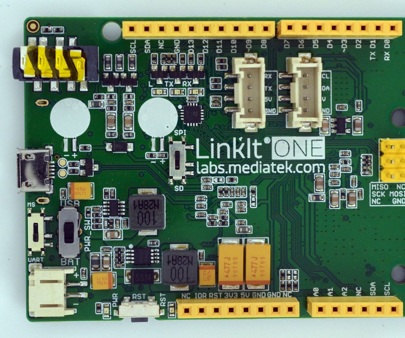

Introduction: [LinkIt ONE] GPS Tracker + MediaTek Cloud Sandbox Tutorial
This tutorial is to show how to build a wifi-based GPS tracker with MediaTek Cloud Sandbox and even on mobile app.
