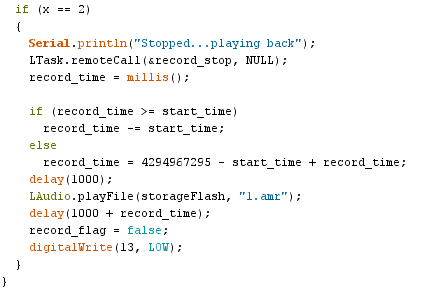

I modified the code by zhyena to record when you type 1 in the serial monitor and stop recording and playback when you enter 2. This way you do not need any additional hardware!

There are a couple of limitations for this project. First if you use the code I provide, your recordings will have to be short because they are saved on the 10mb on-board flash. You can change this by setting the SPI/SD card switch to SD and changing all occurrences of storageFlash to storageSD.
Also, you have to be careful what microphone and headphones you use. If you use a microphone/earphone set that terminate to one plug then you should be ok. If you don't have one of these then you can connect a regular microphone but only insert it half way in. This is what I did to record.
If you are not able to playback your recording, unplug your board and change the MS/UART switch to MS. Plug it back in. You should see a 1.amr file. Play it. This is a good way to troubleshoot the issue.

- Open the serial monitor and type 1
- Say something(remember to keep it short if you didn't edit the code to store on an SD card)
- Enter 2
- Listen to your recording
