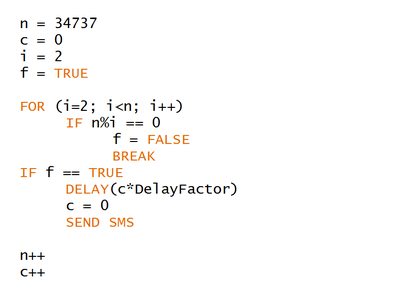

For each number check if it is prime and if it is, notify user via SMS. To decide whether or not a number n is prime, we must try to divide it with every number from 2 to n-1 and see if remainder at division is always not 0. If that is true, n isn't divisible with any number except 1 and itself, which is the definition of a prime number.
This algorithm could be optimised by checking only odd numbers (all even numbers are divisible by 2 and thus not primes) and checking to only sqrt(n) instead of all the way to n-1 (there is no divisor of n that is greater than sqrt(n)) and most importantly, we could only divide with primes. Why didn't I do that? LinkIt ONE is so powerful it finds primes faster than they could be SMSed.
Now the question is how to make those SMS' interesting if they would be coming all the time? as it turns out there is no way of telling how far apart two primes will be. It will always be at least one not prime between (with exception of 2 and 3) so why not use that? When a prime is found, program will halt for time determined by how far apart last two primes, multiplied by delay amount.and only after that SMS will be sent and next number will be tested.
If you take a look at attached code you will see that I also added a "limbo" - part of code with no escape - where program gets stuck if it exceeds 32 bit long int limit and goes back to counting from 1 upwards (we don't want this).

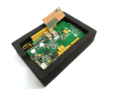

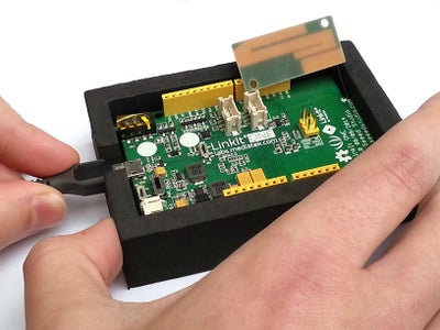

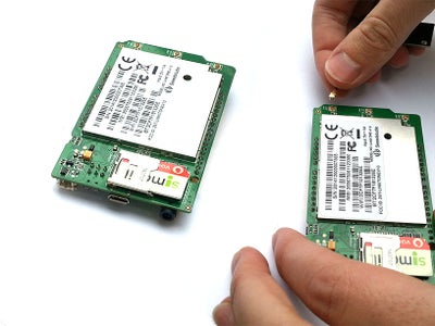

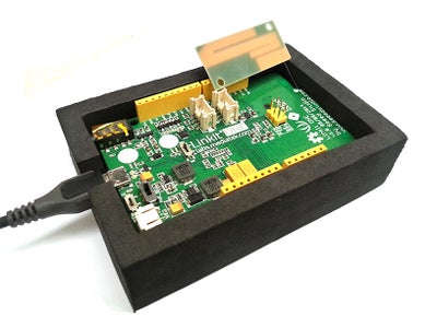

Done tweaking? Upload the code, power off the board, insert a sim card (without PIN), attach GSM antenna, power the board and go on with your life, do whatever you were doing. Forget about all of that and be surprised when you get an SMS!
The foam case is from my other instructable which you can find here.
