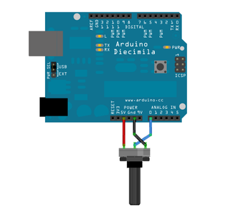

Step 2: Test

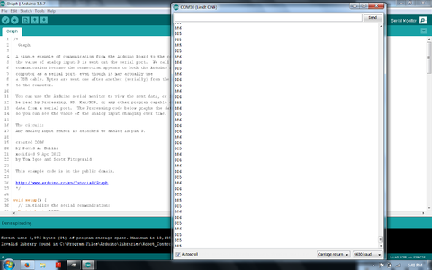

You can upload the sketch as is, no changes to the code are needed. To perform the test, after uploading the sketch to the LinkIt One connect the middle pin of the pot to the 0 analog pin on the LinkIt One as shown in the example. The other two pins connections are 5v and Ground. After you have it configured switch from your debug port in the IDE to your modem port then simply open the serial monitor and watch the values change as you turn the knob on the potentiometer.
With the 10K potentiometer connected to the LinkIt One the readings in the serial monitor run from zero to 1023. So it appears to be reading the resistance which is very interesting to me. So a reading of 100 in the serial monitor equals 1K ohms. That is just so cool to be able to just load the sketch, connect the potentiometer and then read the monitor. Or maybe I'm just too easily impressed.
