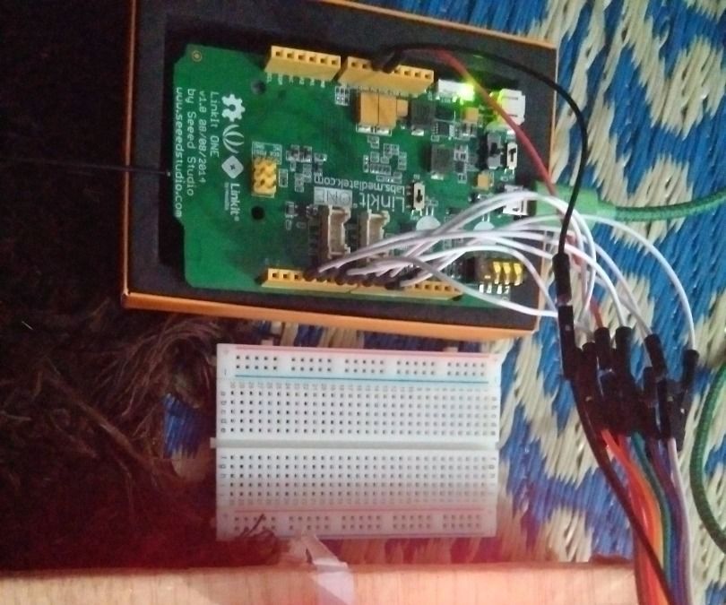

Introduction: LinkIt One SMS Based Home Automation
Now again i came up with new variant of home automation with linkit one based on GSM SMS service.Now you can control your device from any where in the world.I am so excited to explain you its my best project of my life because its communication on sms service which available on every mobile phone and also no need to buy any smartphone to control your electric equipment.

Step 1: Make Your Board Alive With My Code
- Connect linkit board port in debug mode (You can see port info in device manger port section)
- Upload my given code in this section
- Now move port into modem mode and open serial console to see the progress
- Now get any mobile and send message below given formate
- If you want to "on" pin 5 then open your message and send message to inserted sim in board
Type "N 5" for on the pin 5
Type "F 5" for off the pin 5
