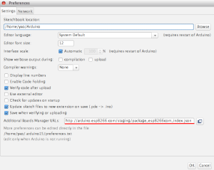

2. Install Arduino core for ESP8266
Install Arduino 1.6.8 from the Arduino website.Start Arduino and go to File –> Preferences .Enter http://arduino.esp8266.com/stable/package_esp8266... into Additional Board Manager URLsfield. You can add multiple URLs, separating them with commas.
Open Boards Manager from Tools –> Board menu –> Boards Manager.
Search and install esp8266 platform (and don’t forget to select your ESP8266 board from Tools –> Board menu after installation).
