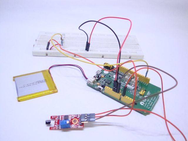

The first very basic step is to connect the linkit one battery to it. For this, you just have to plug it in your linkit one.
Step 3:
The next step is to connect an LED to linkit one. You can follow the images above. You may need to use a BC547 transistor or the brightness of the LED would be too low. I connected the LED to digital pin 2.
Step 4:
Next, connect your light sensor to linkit one as per the following:
- Vcc sensor ------------------- 5v Linkit
- Gnd -------------------------- Gnd
- Vout ------------------------- A0

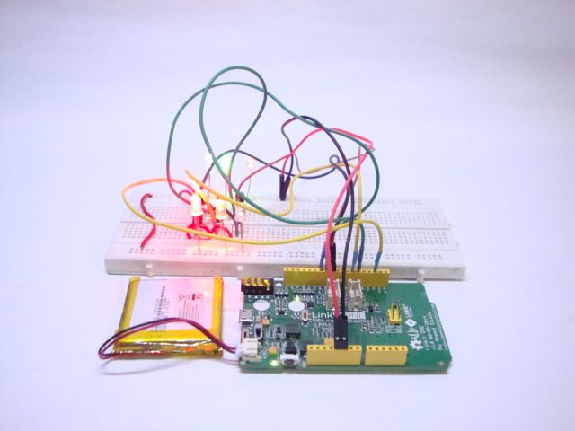

Step 6:
Finally, after completing everything, switch the device on. Initially, the LED would be off but when you switch off your room lights or go to a dark room, the LED would glow indicating darkness.
