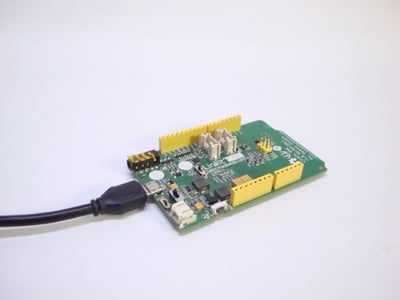

• Linkit ONE

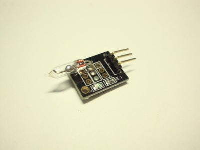

• Mercury tilt switch

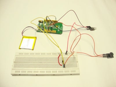

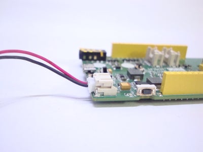

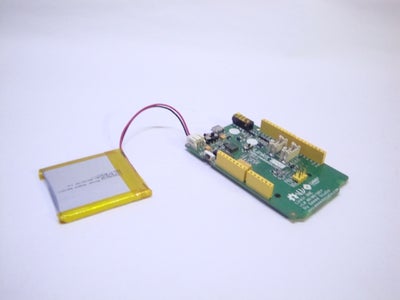

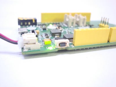

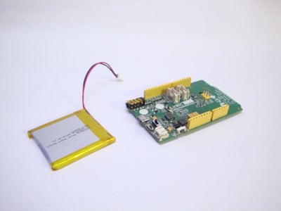

Step 2: Connect the Battery
Connect the 3.7v Lithium battery provided with the package to it's respective socket on the linkit one board.

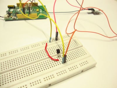

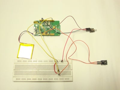

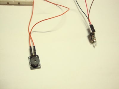

Step 3: Connect the Buzzer
Connect your buzzer module to linkit one through a BC547 transistor as shown in the image above. The transistor is required to make the buzzer more louder when there is a tilt detected in the switch. Use a breadboard and jumper wires to connect it.

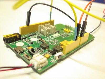

Step 4: Connect the Tilt Switch
A tilt switch is a kind of a sensor that closes when it is tilted. It has mercury inside which on tilting completes the circuit. Here it will be used to detect an earthquake. Connect it as per the following:
• Vcc ------------- 5v linkit
• Gnd -------------- Gnd
• Out --------------- A0
