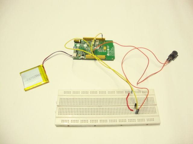

Step 2: Connect the Battery
The first step or the easiest step is to connect the battery to linkit one. Simply plug it to it's socket.
Step 3: Connect the LED
Next step is to connect the LED. You can follow the images provided above. The digital pin that you need to use is- pin 2.
Step 4: Connect the Sensor
Connect the touch sensor to linkit one as per the following:
- Vcc --------------------- 5v of linkit
- Gnd --------------------- Gnd
- Out ------------------------ A0

Step 6: Test
After completing the project, switch in on. On touching the probe of your sensor with your hands, you will observe that the LED lights up!
