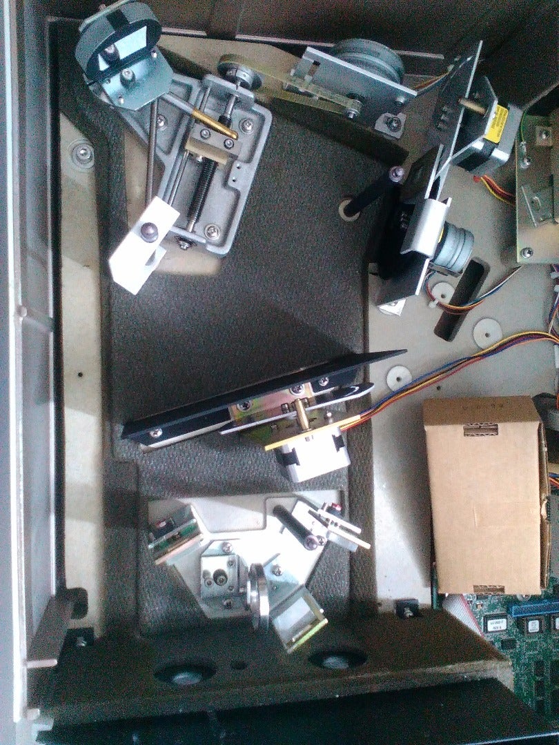

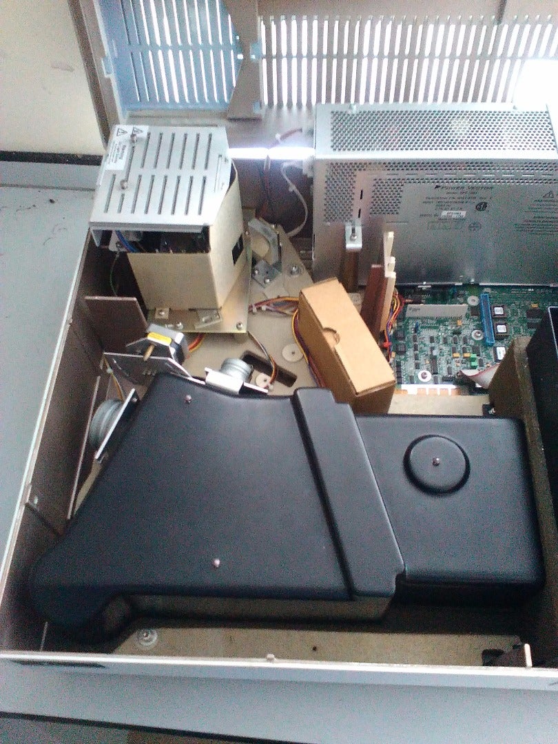

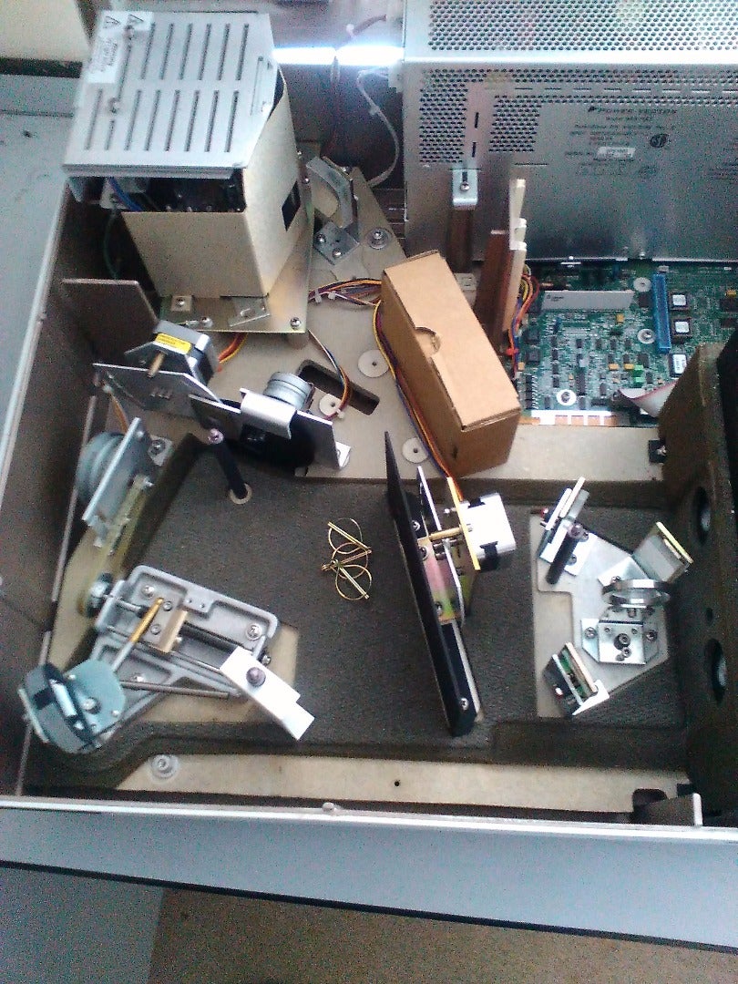

Step 1: Collecting the Parts

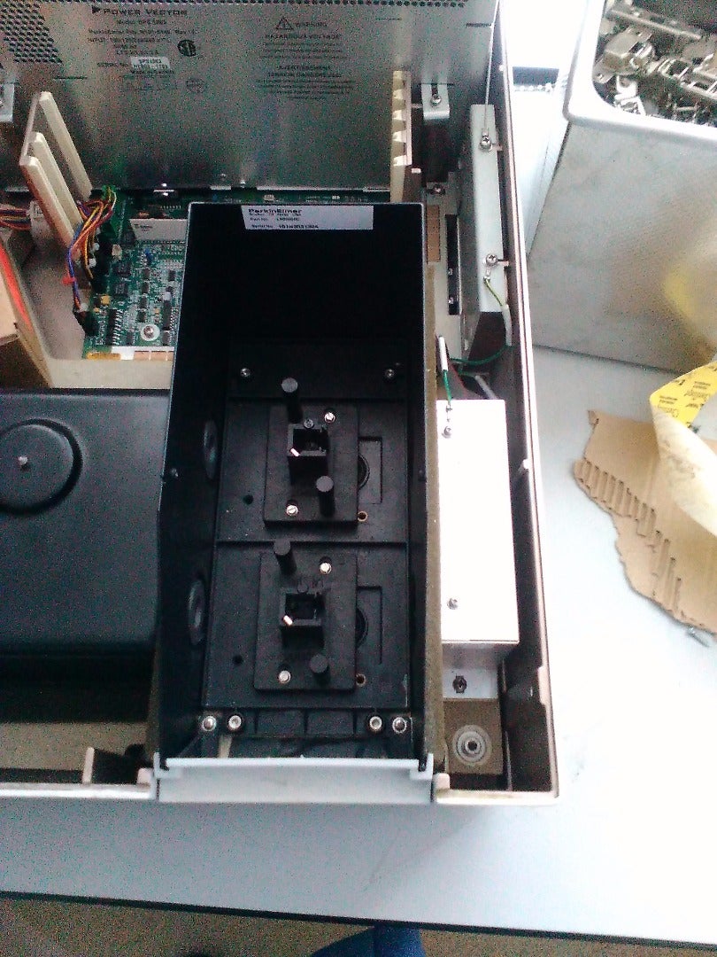

As you can see the inside of a spectrometer is both complicated and surprisingly simple.
Complicated - there is a lot of circuitry designed to just take care of the operation of in excess of 6 stepper motors, as well as additional boards inside the sensor head for the collection and processing of the light signals prior to the information being sent to the software.
I did not want any of the electronics as there was no way to access it, and the whole idea for this guide is to see if the Linkit One could produce a result, so I removed all of the stepper motors, filters and optics as well as the sensor head.
With all the parts removed I would need to know how to set them back up on the base as I would be using a piece of MDF for that. (The original base being to heavy to carry in my back pack), so I use three pieces of paper laid over the holes in the base and made holes in it at the points where I would need screws in the MDF. To ensure that the papers lined up correctly I put reference marks across the joins which could then be used to re-align the paper later.

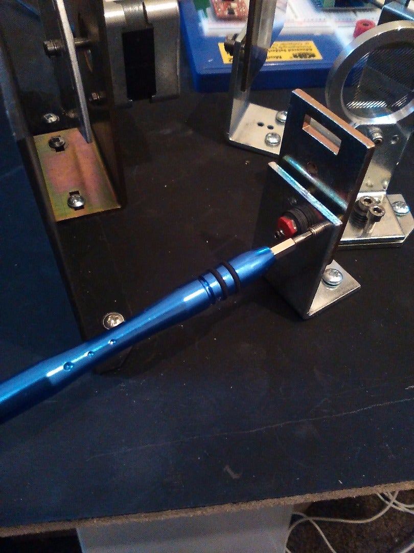

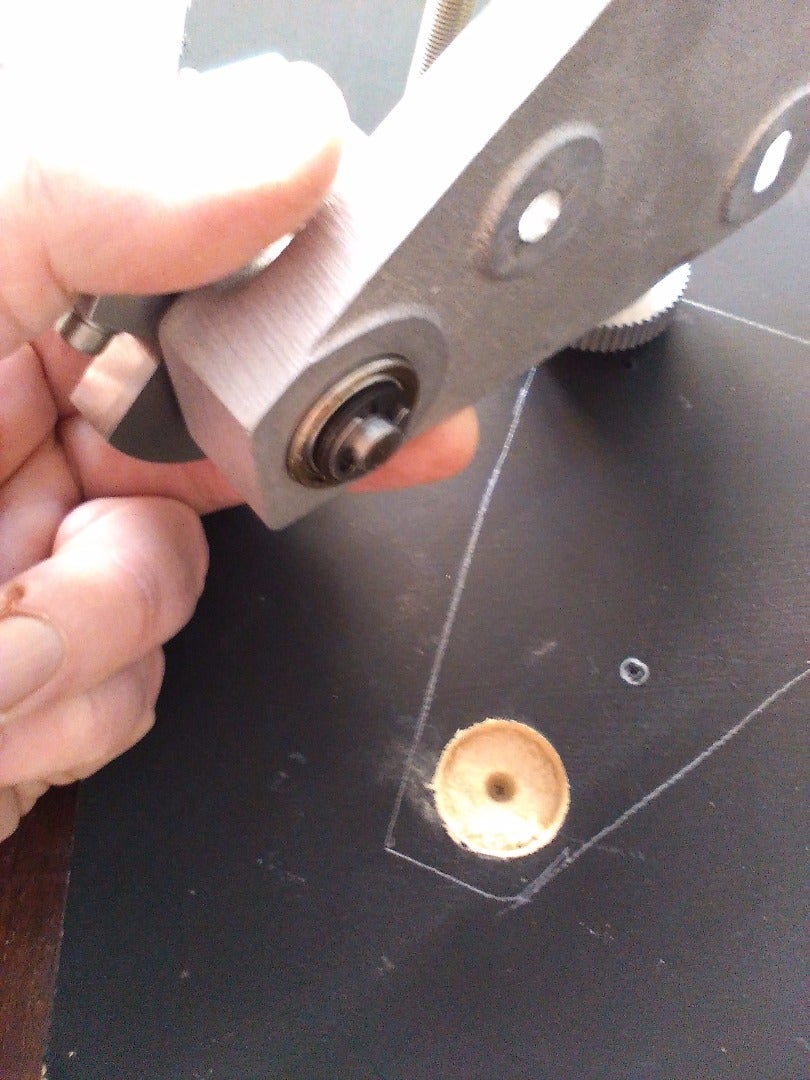

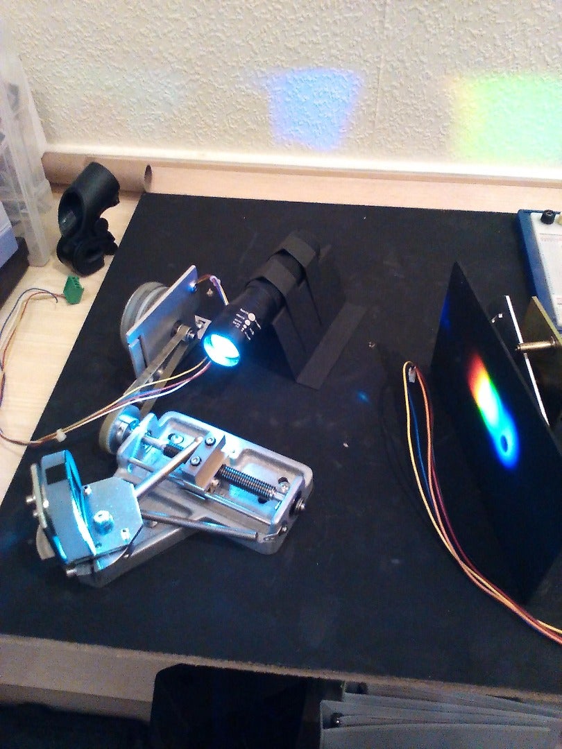

Step 2: Laying Out the Instrument
My Son helped with the construction of the new spectrometer, he put al of the parts out ready to be fastened down, then used the paper templates made earlier and traced over the holes with a marker pen to leave dots on the MDF. I then let him use a small pilot drill to drill each point.

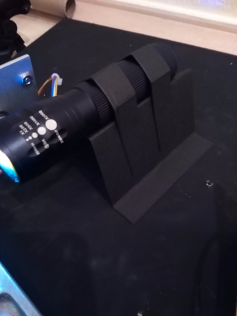

Its important to reduce light surfaces as much as possible so we then used mat black and painted the whole board, after which we screwed the parts into place. NOTE that it was important not to touch any of the reflective surfaces as this would only add to the errors that the home made instrument would already have.

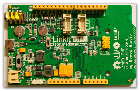

Install the Linkit One board
The board comes with a 5 step plan that takes you to all the locations you need and here they are - all you have to do is follow the links and use the videos freely available of the suppliers web sites:
1. Install the Arduino IDE 1.5.6 or later (I recommend the 1.5.6) Arduino.cc/en/main/software
2. Register on MediaTek Labs – labs.mediatek.com/register
3. Download Linkit Developer’s Guide – labs.mediatek.com/Linkitguide
4. Install Linkit SDK for Arduino – labs.mediatek.com/linkitsdk
5. Select the Linkit One board (from Tools / Boards in the Arduino application)

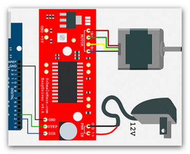

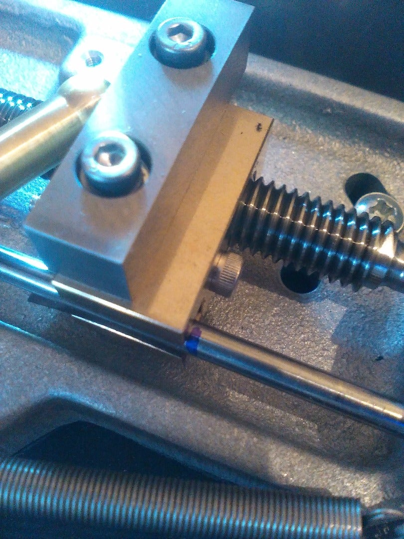

Step 4: Stepper Motor Control
The first part to get working was the stepper motors - I was originally going to use two of the motors, the traveling convex mirror and the slit stepper, which would be connected to the Linkit One via an EasyDriver board. At that point I noted that the slit stepper was a five wire unit and currently I do not know how to wire this type to the easy driver.
Chage of plans
So While I still need the slits and you can see that stepper installed in the remaining pictures it will be moved manually s required. The important motor is the traveling mirror as its this one that splits out the light spectrum and then allows you to move it over the slit, so creating the initial beam that is then split by the mirrors that follow and the diffraction grating.
I needed to know how far to move the mirror so I wrote a little script to run from the board and adjusted the number of counts until I had the movement correct.

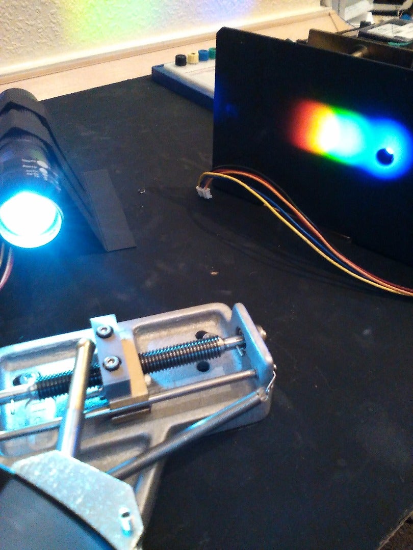

I started by manually moving the worm wheel until the spectrum of light was at the start of the slit position and then marked the guide bar with a pen, then I started the script and made a second mark on the guide rail as the spectra's other end passed the slit position. This gave me the distance of travel. This is the code for the travel test.

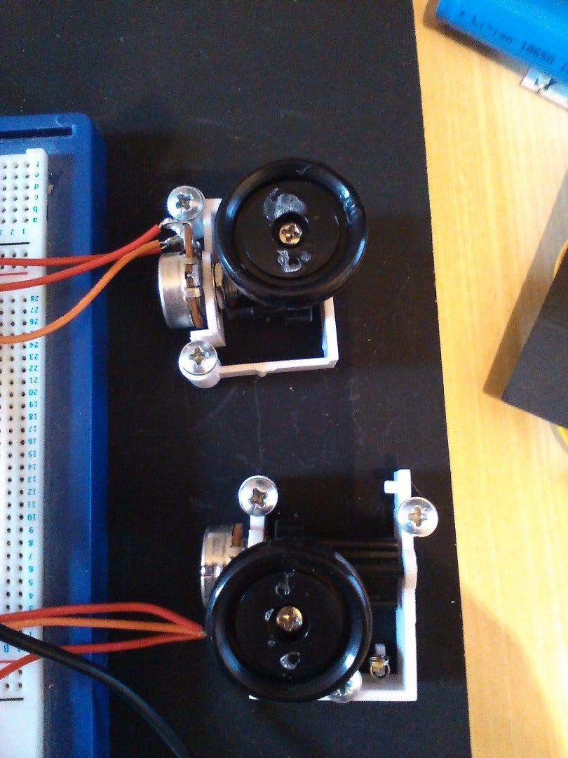

Step 5: Dual Beam Setup and Testing

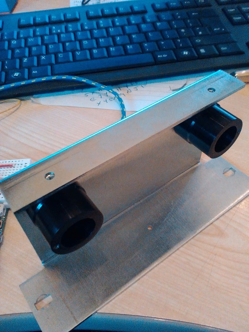

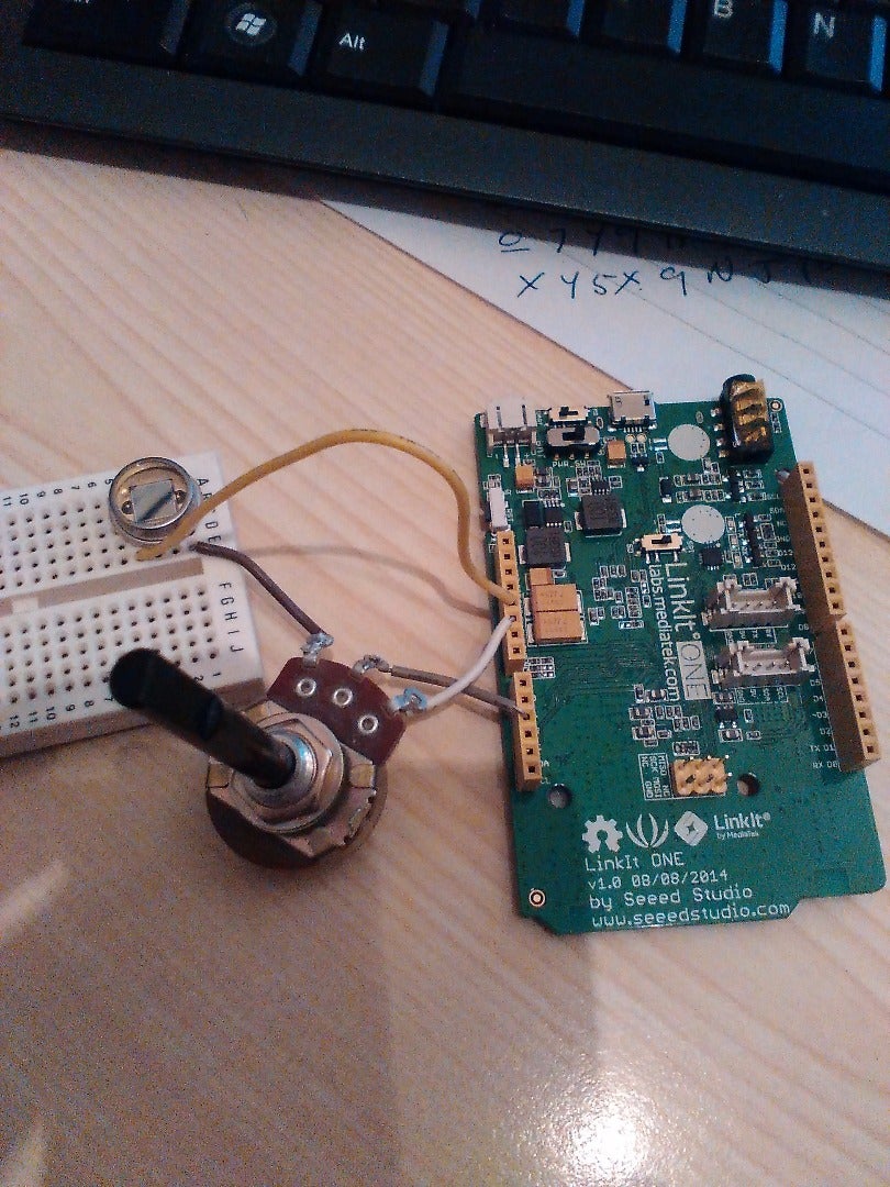

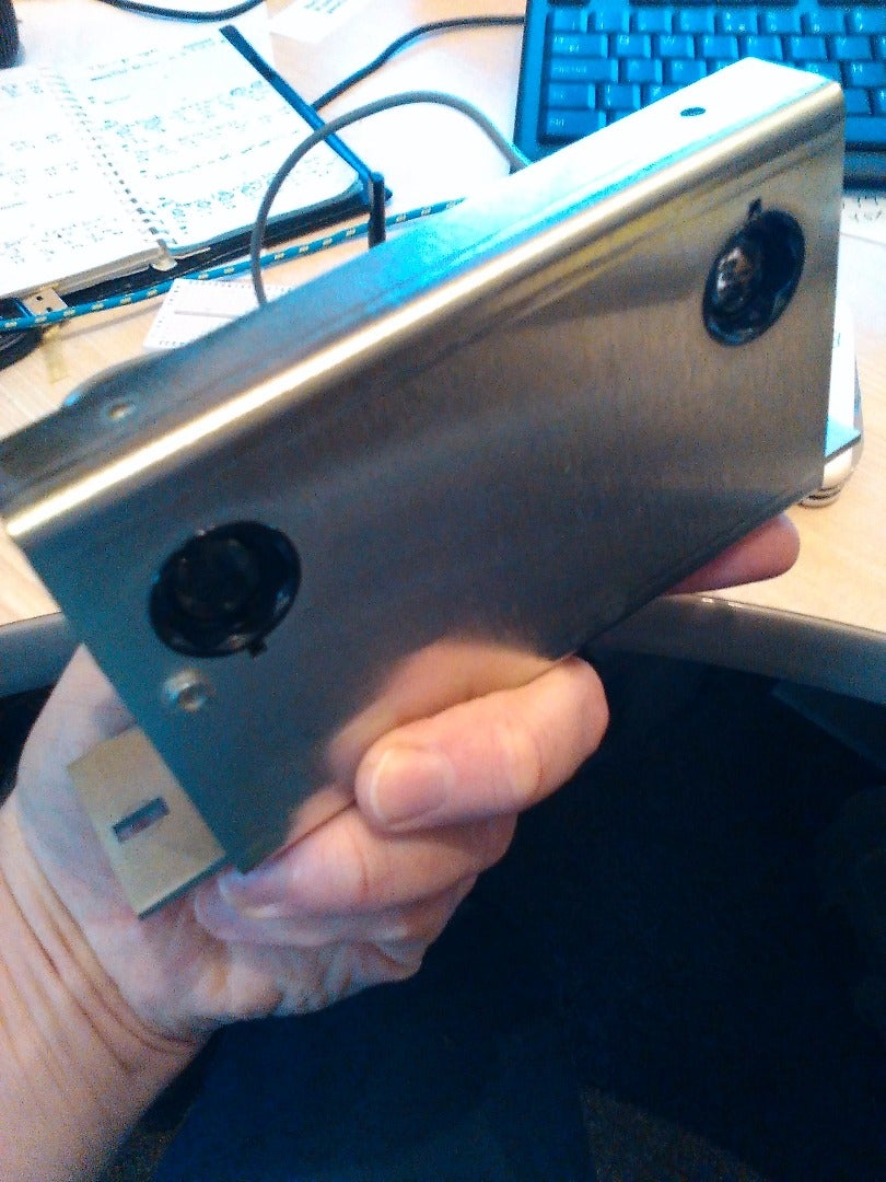

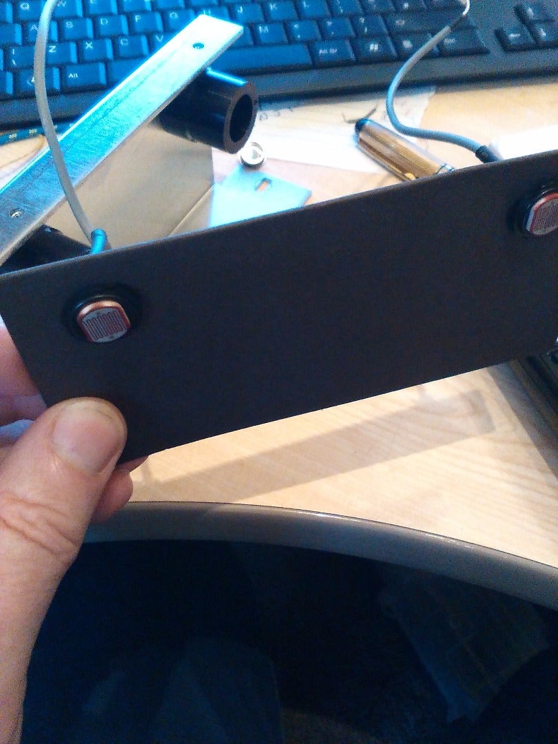

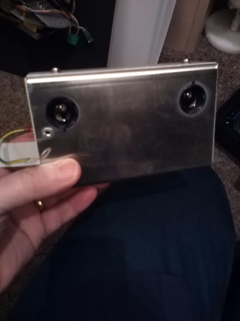

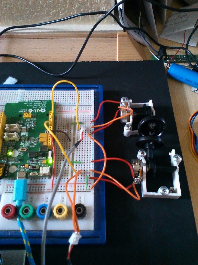

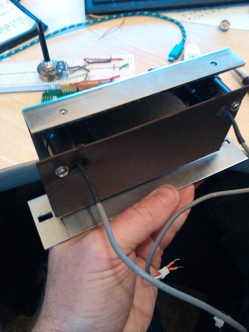

When I opened up the sensor head I found another very complicated board (not usable for this project), so I removed the optical sensor from the board and wired it to the Linkit One to test the output, however I found that the range of the sensor is very limited, so probably the function of the original circuitry was to amplify the signals as well as send them on to the software. I was forced to fall back on Light Dependent Resistors (LDR)
I used another piece of card attached the LDRs to this passing the wires through the card and then fixed the new sensor board to the original base plate magnifying lenses.

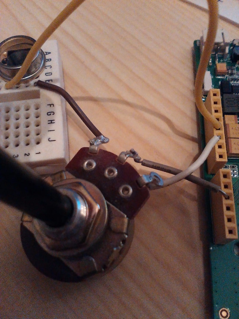

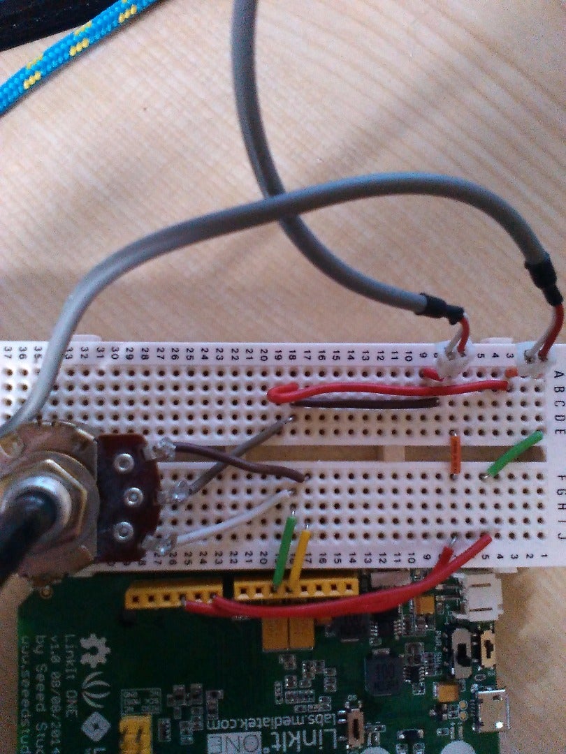

I then wrote a script to collect data from both sensors Thats when I found another issue, the wiring I was using connected two LDRs through a single variable resistor - the theory being that by collecting the POT value for each from a different pin on the board I could balance the signals using the variable resistor. However I found that one LDR was less sensitive that the other so balancing this way did not work.
I had to rewire both so that each has its own variable resistor - the drawback is that is is now harder to align to the two separate values.

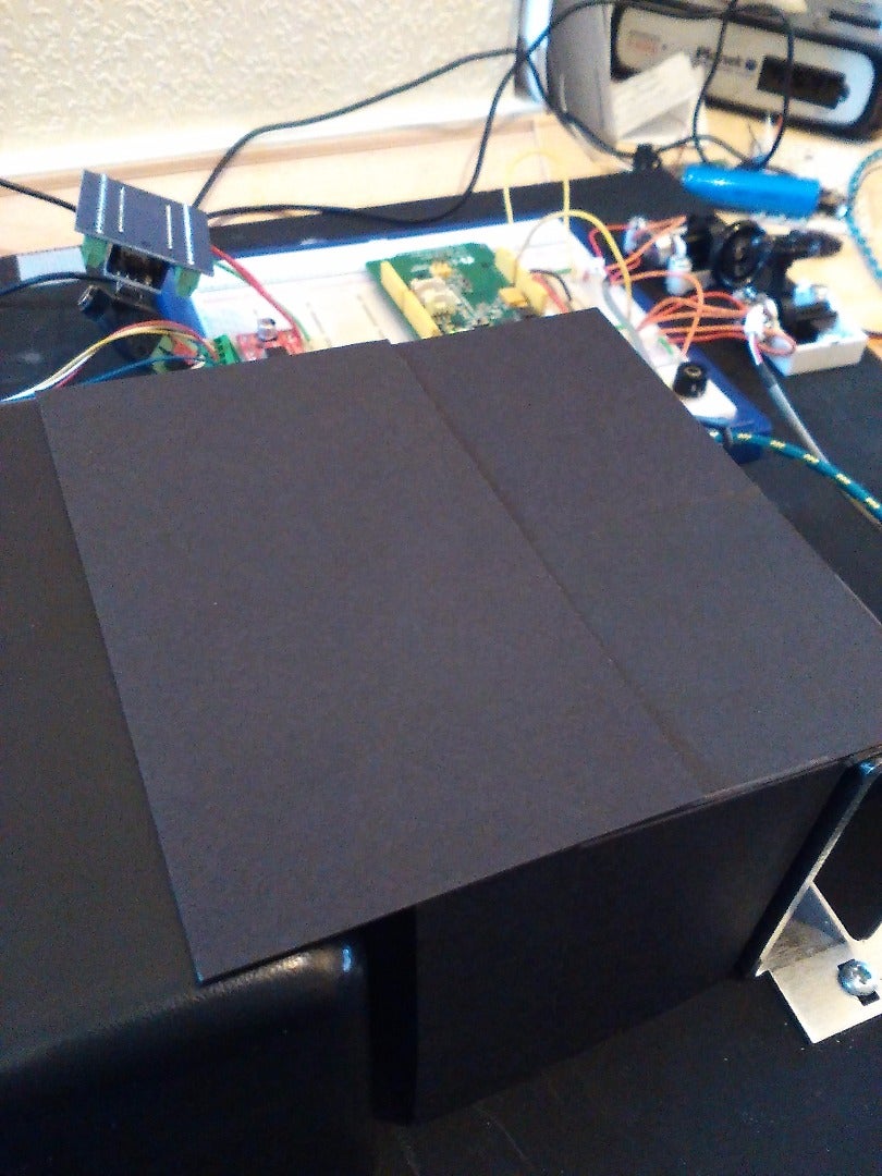

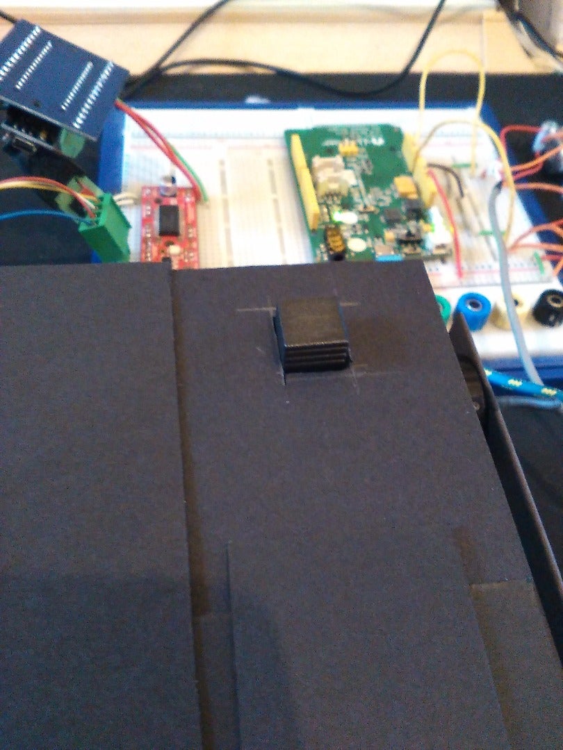

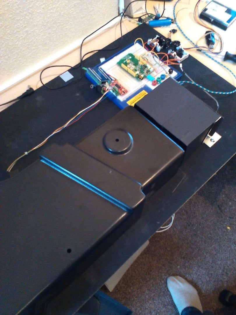

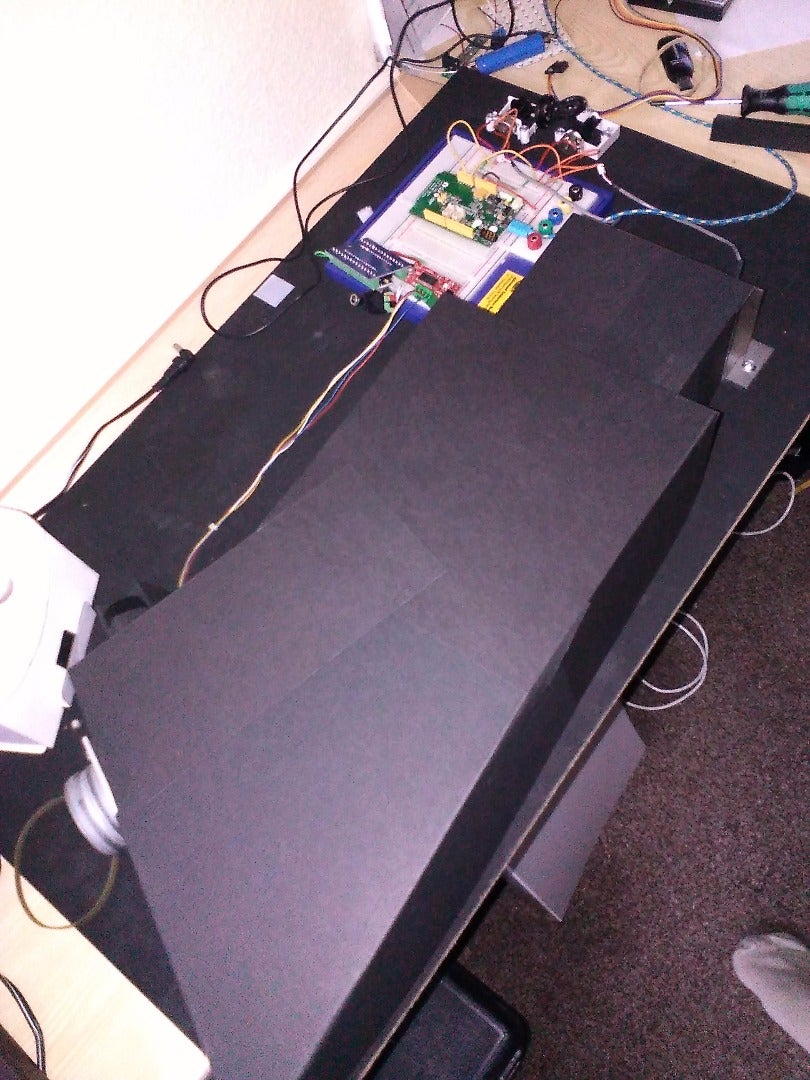

Step 6: Shields and Light Support

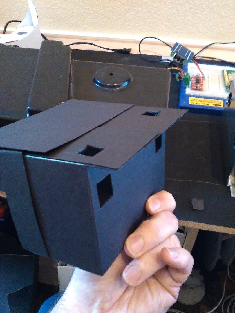

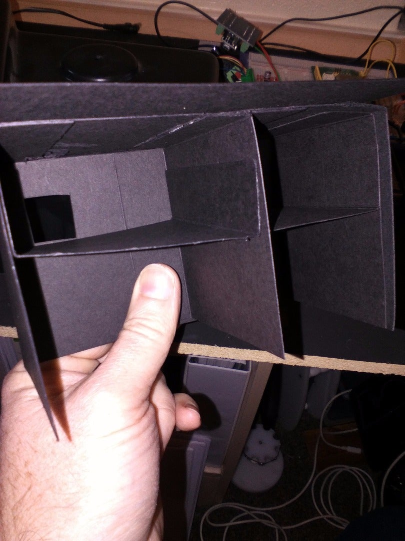

In an attempt to recreate the shielding I used my wifes card making tools to crease and then fold sheets of black card to make boxes to go around the lenses and samples. I used the same method to make the support for the torch (which is the light source - a single high powered LED cycle lamp with a focusing lens to concentrate the beam)
All car parts are held together using double sided sticky tape.
Unfortunately, while the main shield works, it was too light weight and kept moving during testing the beams which then obstructed the beams, so I reverted to using the original plastic shield for the main workings, only having to cut out a large section to allow it to sit over the torch.
I still had to make a cover for the sample area, as you can see I put a separating wall between the two beams and then placed cut out holes for the beams to pass through at the front as well as holes to allow me to insert samples at the top.
The beam holes where aligned by turning the lamp on then, with the shield in place, using a pencil to mark the points where the beams hit the card. I also added sufficient card to the top to overlap the main shield at the rear of the sample cover and at the front where the sensors are located.

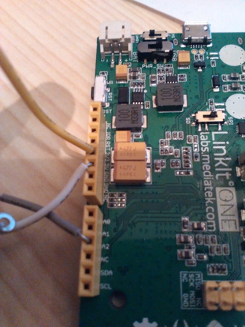

Pin Connections
Optics
NOTE
- The bread board is used to allow multiple connections to the same pin
- When wiring the Variable resistors I tried keep the wiring consistent in terms of which leg was sent to GND and Which to 5V
LDR 1 - Sample
- Pin GND Variable resistor Outside Leg
- Pin A2 One side of the LDR, the second side of the LDR goes to the middle leg of the Variable resistor
- Pin 5V Variable resistor other outer leg
LDR 2 - Blank
- Pin A0 One side of the LDR, the second side of the LDR goes to the middle leg of the Variable resistor

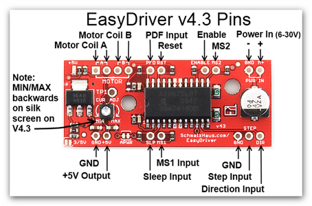

Motor Linkit One to EasyDriver
- Linkit Pin 2 to ED Dir (Direction pin)
- Linkit Pin 3 to ED Step (Motor Step Control)
- Linkit Pin GND to ED GND
The Stepper motor is wired by trial and error , however if the wires are already in a plug then it should just be two attempts, and power is supplied to the motor via 9v adapter.

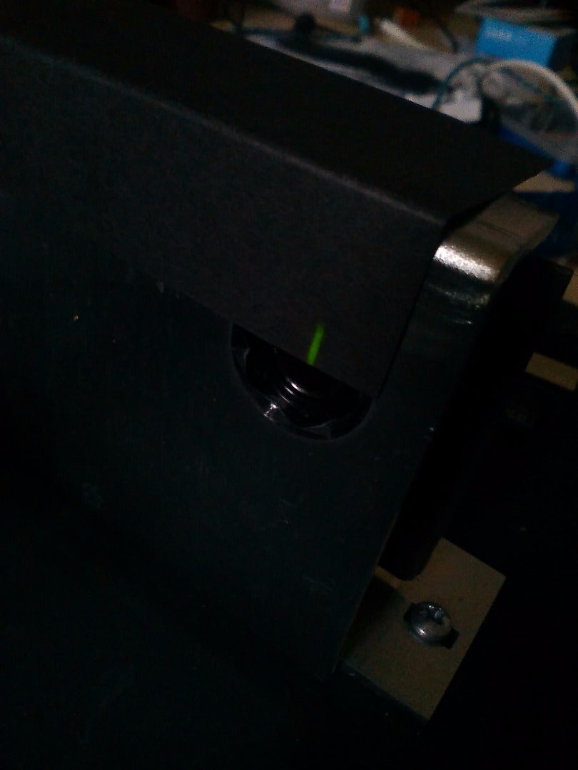

Step 8: Balancing the Beams
With the drive belt off I manually set the spectra to the green area and then adjusted the mirror screws so that the beams of light fell exactly onto the individual lens for each LDR (there is a horizontal and vertical adjuster for each beam as well as the same again for the mirror at the front that moves both beams at the same time.
Once the beams where balanced I then set about zeroing the signals.
This was done by firstly removing the drive belt from the stepper motor and manually setting the mirror to the green part of the spectrum (just to get a bright light coming through) It does not really matter you are only trying to get balance between the two LDRs so that they should read approximately the same with nothing in the way.
You then set the spectrometer sketch going and capture the data on the serial monitor - while its running adjust the variable resistors - I set the blank so that it delivered the maximum value and the set the sample to match it. This had the result of giving 100% transmittance and zero absorbence at the sample beam.

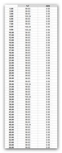

See the charts

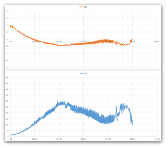

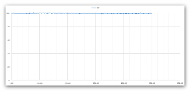

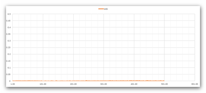

Step 9: Absorbsion and Transmition
What you see in the Charts are the values obtained from 4 separate standard filters.
You must remember that this "instrument" is home made and that there is no noise compensation and as such the signals are very messy, however you can see that with the data being specific to this set up each filter does give a very different profile, so if you have a set of known standards it should be possible to identify an unknown composition sample or even get an idea of concentration.

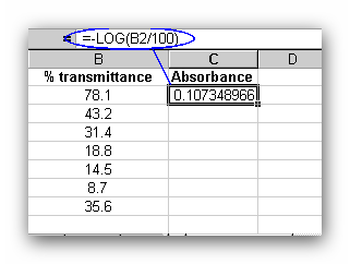

The data for Transmission was calculated relative to the reference path (the one with no filter inserted) , once that was calculated the absorbance can be worked out from the equation :-
A=-log(%T/100)
The attached excel files contain the individual readings obtained for each filter. I have combined them into an additional file (normalized) and then adjusted the values to fit on a scale for 100% Transmitance.
